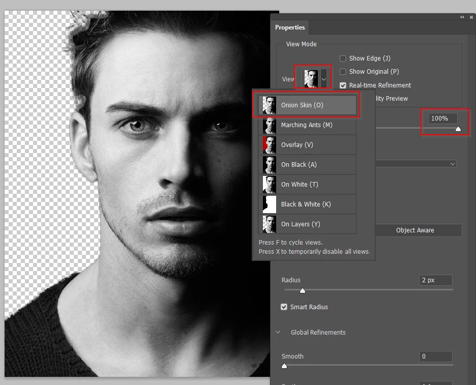

What View setting are you using with Select & Mask?  Try setting it to Onion skin and Transparecy to 100%
Also try turning off other layers. You can see above that I have nothing behind the selection and can see what I am doing

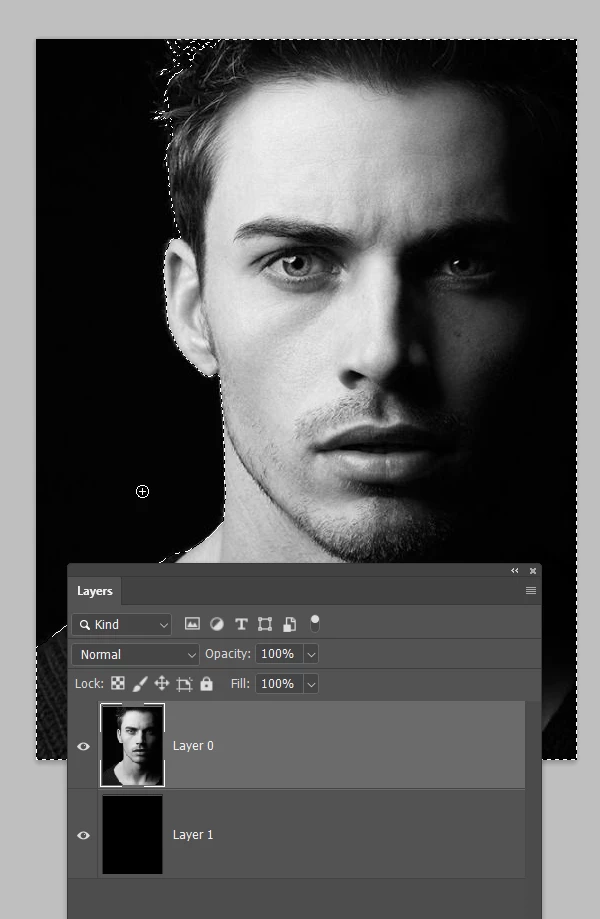

But if I have the situation below with an underlying layer filled with black
Then Select & Mask is difficult to use because the black layer below is visible.
Note I have change the View setting to Marching Ants so we can see the selected area.
