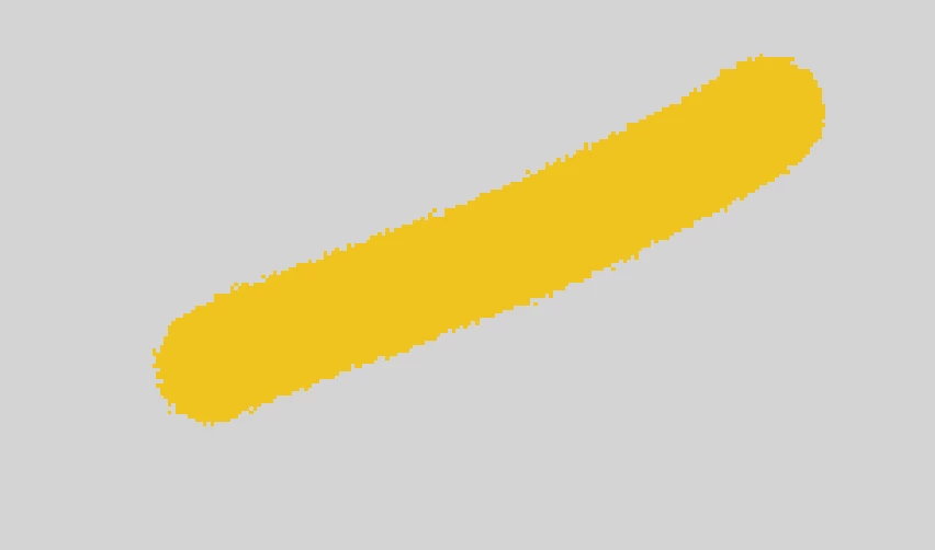

My brush tool only paints like a spray can and I can't fix it
  • April 28, 2021
  • 3 답변들
  • 4494 조회
I hadn't changed any of my brush settings and midway through using it, it's changed itself and I can't fix it. I usually like using the hard round brush but now it's stuck looking like I'm using a spray can line and I don't need that. It now doesn't matter how I change the brush tool, it's stuck on this one setting.
I've tried resetting all of my tools and restarting my computer and it still is broken and I can't find anything else to try. Any help is greatly appreciated

Your layer is set to dissolve mode
Dave

Can you post screenshot with entire window and Layers panel visible?
Dave
jane-e
April 28, 2021
Hi
Check the options bar and change the Blending mode to Normal. It may be on Dissolve. If you don't see it, then show a screen shot of your options bar.
~ Jane
Madelyn5EB1작성자
April 28, 2021
Thanks for the reply. The mode is on normal
jane-e
April 28, 2021
@Madelyn5EB1 wrote:
... midway through using it, it's changed itself
The shortcut to change to Dissolve is Shift+Alt+I, which you may have done accidentally when you were trying to do something else. It will change the Layer if you are on the Move tool or the Brush if you are on the Brush tool. See a complete list of shortcuts for Blending modes in this list from Jesús Ramirez:
https://photoshoptrainingchannel.com/tips/all-photoshop-blend-mode-keyboard-shortcuts/
~ Jane
