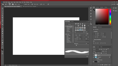

Could you please post a screenshot with the pertinent Panels (Toolbar, Layers, Brushes, Brush Settings, Options Bar, …) visible?
What are the Tool’s Blend Mode, Opacity, Flow, …?

And I see the outline when I try to use the brush but when I click nothing happens
Jun 27, 2020 Jun 27, 2020
You have the History Brush selected.  It must be ten years at least since I used the History Brush.  Possibly nearer to twenty!  There are much better ways to duplicate its effect, and with much more control.
 If you selected it by accident, then think about remove its shortcut (I can even remember if it has a shortcut).
A nice way to avoid this is to create a new workspace with all the options checked.  If you ever need the default shortcuts or tools, then switch back to Essentials.
