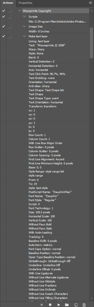

You can step through an action and observe each step operation.  If you see you want to change or add some step. You can stop stepping that the action and switch to record mode or use record again on the step you want to change. Add or change the step or steps you want. Then  position to the Step you added or change step back in history if you had played the step and  then continue stepping through the action.  The Action Platte scrolls the steps as you step through the action.  There is not need for an action to fit on your display.  In fact a singe step like a text layer step and layer style and others if fully expanded the single step may not fit on your display. I found an old Action  I used in the past to add a Copyright text layer.  I needed to update the text layer step yearly I have not updated it since 2008 look at the size of the make text layer fully expanded so you can read what has been recorded for the step. It fix not on my display the full step would need a display 3 timed higher than my display.
