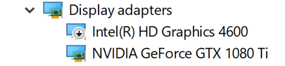

I updated Photoshop 2019 and the Nvidia drivers, just in case. I also disabled the onboard video, just in case:

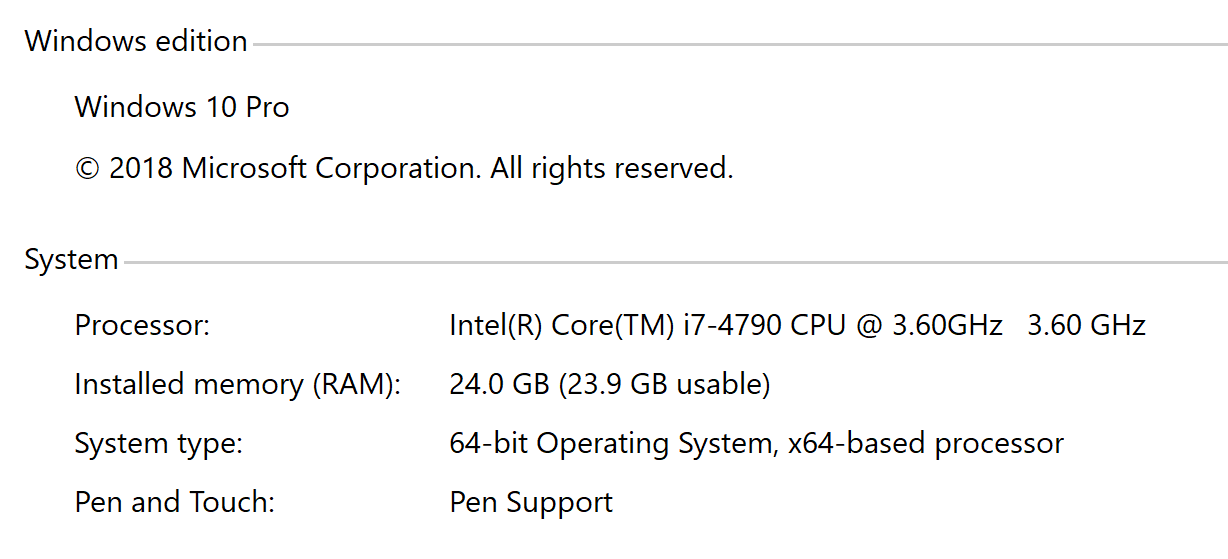

Some basic specs for anyone curious

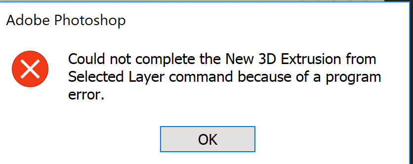

I have one monitor attached, and none of the 3D functions work. I get this message when I try to import an STL.
All is not well.

If you read the information, or look at the screenshots, you can seen that It's not what I said the problem was, and the error message clearly says "OpenGl Disabled"
For example, if I attempt to open an STL file, I get the error above. If I try to do "New 3D Extrusion from layer" I get this:
So, there's really really a problem. I went through a lot of sources before getting here. Is there any source to solve these technical problems?

Dual graphics.
This is known to cause problems and Adobe specifically and officially warns against it. Disable the Intel adapter.
New Here ,
Nov 16, 2018 Nov 16, 2018
If you read the discussion (or look closely at the screen), you'll see I already disabled the onboard video, and then rebooted for good measure in case that wasn't enough.
