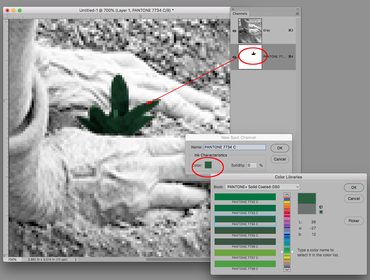

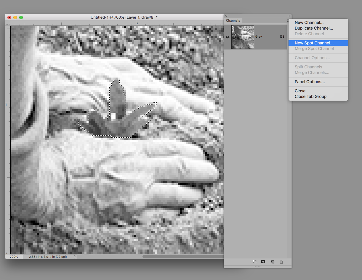

With the image in grayscale mode, select the leaf and choose New Spot Channel from the Channels panel
Click Color to select your Pantone spot
Color correct the two channels as needed, Save as .PSD, and place:

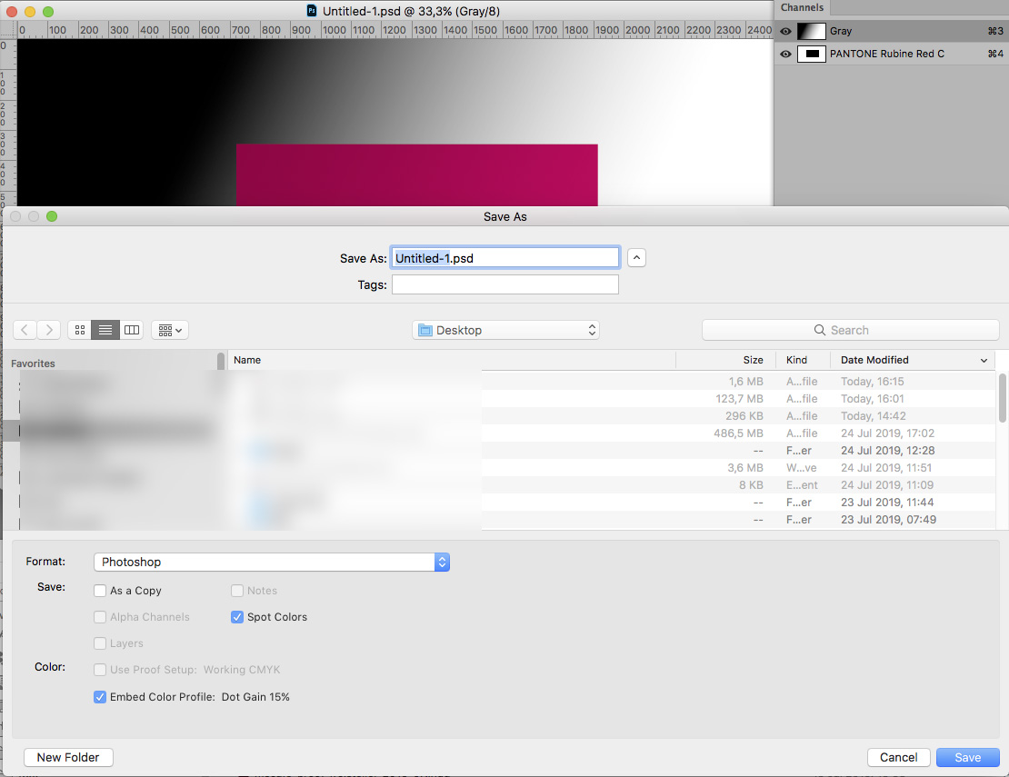

Jul 30, 2019 Jul 30, 2019
been there. it you save as anything other than duotone or greyscale [e.g. psd], the printer cannot run it as a black and one-spot color file.
My example is being saved as a .psd grayscale, and InDesign is correctly separating the spot as you can see in my Separations Preview panel.
