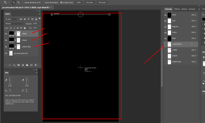

Hello community, hope eveybody is doing great!
Can anybody help me with my code? I am trying to copy all the info in my alpha channels (spot colors maybe?) to create layer with it's name, I found this one:
and works good! but it creates things that... I don't know what are they like the ones I point in this screen shot:
The image is in "negative" if I explain myself good, the layers seems to be masked and I need it like a normal layer, I don't know what is that channel I am point which gets the name of the layer I choose, idk.... Here is a code I've been working but I honestly surrender, sorry about the spanish:

ref2.putEnumerated(idchannel, idchannel, stringIDToTypeID("mask"));
desc10.putReference(stringIDToTypeID("null"), ref2);
executeAction(stringIDToTypeID("delete"), desc10, DialogModes.NO);
} catch (e) {}
var desc2 = new ActionDescriptor();
desc2.putClass(stringIDToTypeID("new"), idchannel);
var ref1 = new ActionReference();
ref1.putEnumerated(idchannel, idchannel, idmask = stringIDToTypeID("mask"));
desc2.putReference(stringIDToTypeID("at"), ref1);
desc2.putEnumerated(stringIDToTypeID("using"), stringIDToTypeID("userMaskEnabled"), stringIDToTypeID("hideAll"));
executeAction(idmake, desc2, DialogModes.NO);
var desc3 = new ActionDescriptor();
var desc4 = new ActionDescriptor();
var ref2 = new ActionReference();
ref2.putIndex(idchannel, theIndex);
desc4.putReference(stringIDToTypeID("to"), ref2);
var idpreserveTransparency = stringIDToTypeID("preserveTransparency");
desc4.putBoolean(stringIDToTypeID("invert"), true);
desc4.putBoolean(idpreserveTransparency, true);
desc3.putObject(stringIDToTypeID("with"), stringIDToTypeID("calculation"), desc4);
executeAction(idapplyImageEvent = stringIDToTypeID("applyImageEvent"), desc3, DialogModes.NO);
Copy link to clipboard
Copied
Excellent!!! Thank you so much, I did not think about that, maybe I was too tired yesterday, thank you!

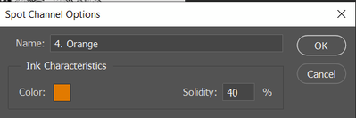

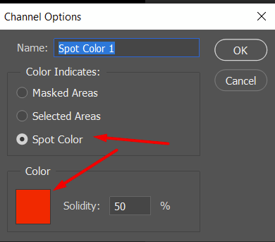

Hello community. I would like to open this thread again.
Is it possible to add to this code the feature to also "set" the channel color to the copied layer? I mean you know taht we can select a color for the channel, right now the code only copies the information on each channel to a layer but it does not copy/set the color, I have to do it manually one by one when layers are generated, is there the posibility to also copy the color from the channel to the layer? Thank you so much.
Copied
@c.pfaffenbichler as this is your code, I thought that it was best to bring this topic to your attention...
Copied
sorry for bothering to both of you
Copied
It's not a bother for me, it is a challenge... Truth be told, I was expecting this to come up earlier!
Edit: Setting the values I can do, but getting them? I don't know how, or if it is even possible to get the colour values of a spot colour channel via scripting. A spot colour channel can use either an installed Color Book (.acb file) link/reference – or it can use Colour Picker values (HSB, RGB or Lab).
Copied
There is an AlternateSpotColors - Tag 0x042b (18 bytes) in the binary data of a PSD file... So perhaps this can be decoded?

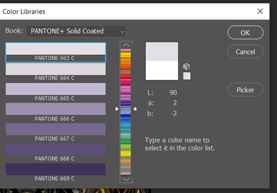

Just to make sure: What color did you select? A custom one or a Pantone color or …?
Copied
Thanks for your answer! What I use the most is alpha channels with pantone colors (Solid Coated), when I create alpha channels with the information I need, I normaly select a pantone color here in the channel, the script has worked perfect all this time! I just was wondering if is possible to also get the color I chose and copy/set it in the new created layer (maybe as a color overlay in the layer?? not sure, I am not too familiar with photoshop script)
thank you!
Copied
@AntonioPacheco – I think that @c.pfaffenbichler was asking for a screenshot of the colour swatch, when you click the orange colour swatch – what is shown, a colour library or colour picker?
Copied
Indeed; but based on the name it seems likely that it was not a Color Book-color anyway but a custom one.
Those should be accessible via Script.
Copied
You probably mean this one right?
Copied
That’s bad; Color Books-colors seem to be »complicated« …
Copied
If you are using Pantone Color definitions why didn’t you name the Spot Channel accordingly?
Copied
That could be the best solution possible, pretty nice suggestion!
