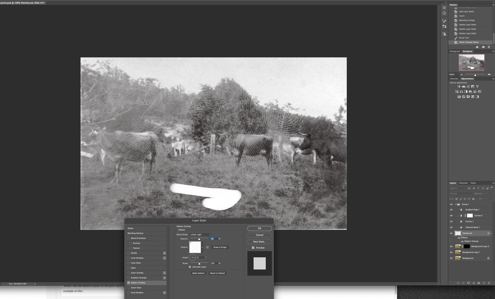

Sorry to pester you again with this but I am still having some difficulty in emulating what you have explained. I am attaching screenshot file as I am unable to upload a psd file in which I have tried createdScreen Shot 2021-02-02 at 10.26.53 am.png and mimic your screenshot example. However there are a number of differences that I do not yet understand. E.g.
My curves 2 mask does not appear to be the same as yours and I am not sure why
With all layers selected, my image is now totally Monochrome, whereas your example still shows the original color tint with all layers checked.
When I use the Brush to paint on the paint layer (using White) it shows as White Strokes (exaggerated example in file)
The Mask on Background copy 2 is totaly black, painting on the Paintbrush layer has no effect.
The Pattern Overlay Pattern I have used is Noise (64x64 pxl) RGB mode at 50% opacity. I could not find pattern called Monochrome Add Noise on 50% Gray.
I appreciate your help in this matter and are keen to improve my Photoshop skills and hence want to understand what I am not getting right here.
