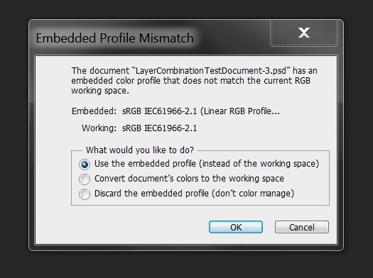

Ok, I see the difference. It's dramatic, far more than I ever see.
But wait! There's more!
What is linear srgb? It's not in my Color Settings choices and the difference when zooming is huge, depending on
whether you have converted or not.

That's a linear profile of my own creation - basically an sRGB profile with a gamma of 1.0 instead of 2.2. I find it useful for testing and astroimage work, among other things.
It happens to enhance the differences but the concepts still apply even when using one of the more typical document profiles.
