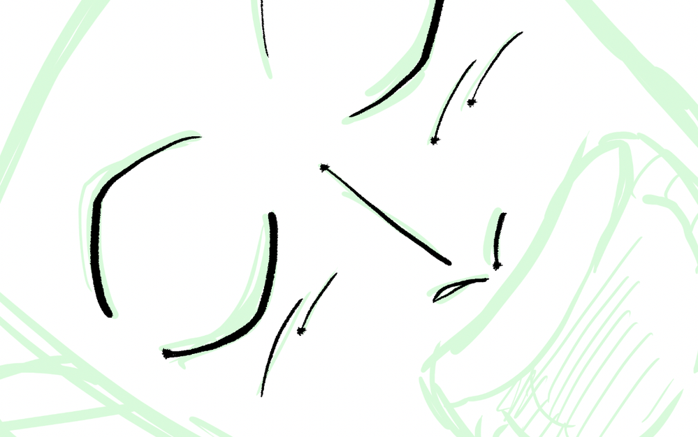

I get these random spots whenever i use my brush on Photoshop 2020. It never happened before in the older version. I use a Cintiq Pro 13. This is frustrating ...  My driver is updated,  these spots are driving me crazy XD
example : Capture d’écran 2020-05-12 à 00.10.31.png

New Here ,
May 19, 2020 May 19, 2020
Thank you nab2000 for posting about this. I have the same problem. A lot of my pen strokes begin with a blotch and I have to keep undoing the strokes.

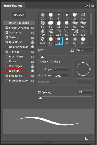

New Here ,
Thank you Glenn for your quick reply.
I tried a few brushes and the default brushes seemed to work well. I looked through my main brushes disabling different brush settings in turn. Disabling Build-up fixed the problem. I can understand why. The part that confuses me is why this wasn't a problem before.
Thank you for putting me on the right track. Thankfully it was just one setting in the brush. nab2000, I hope this helps you too.
Kind Regards,
Zak
