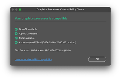

Feb 22, 2022 6:03 AM UTC
Following the instructions in the link provided didn't solve the issue. Below is what happens.
Photoshop 2022
1. Launch Photoshop 2022
2. Create new document
3. App crashes and throws up macOS crash dialogue
4. Relaunch Photoshop 2022 and disable GPU acceleration in the Performace preferences
5. Create new document that works but is slow
6. Before closing document, reenable GPU acceleration and app crashes
7. Help>GPU Compatibility gives me all green checkmarks

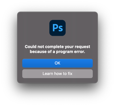

Photoshop 2021
1. Launch Photoshop 2021
2. Create new doument
3. Photoshop error from screenshot "could not complete your request..."
4. Clicking the "learn how to fix" button in the same dialogue goes here: https://helpx.adobe.com/photoshop/kb/program-error-opening-psd.html
5. Nothing here works. "Disable the GPU to quickly narrow down the issue" from that page takes you here: https://helpx.adobe.com/photoshop/kb/troubleshoot-gpu-graphics-card.html#DisableGraphicsProcessor

Feb 10, 2022 5:54 AM UTC
"Learn how to fox" takes you to :
https://helpx.adobe.com/photoshop/kb/program-error-opening-psd.html#Programerrorwhilesavingfiles
None of the solutions on the page work. As stated in the original post, these are MPX modules made by Apple who write their own drivers. These systems run many other GPU heavy apps ( C4D, Octane, Redshift, FCP, Resolve, Fusion, etc ) and none have problems running or simply opening / creating a file. Given the large number of search results over the years representing some version of this problem, the problem itself lies with Photoshop and not the system / drivers that run everything else as expected, including Affinity Photo. All evidence points to Adobe overlooking the current generation of gpu hardware for Intel Macs.

Feb 10, 2022 12:36 AM UTC
Forgot to mention : All combinations of grapics processor settings in PS preferences don't work, including OpenCL checkbocx, cache levels, cache tile size, etc.
