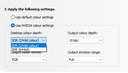

3 - 10 bit output needs to be enabled in the Nvidia driver. As far as I know it's only available with the Studio driver, it is not available with the Game Ready driver. You also need to connect the monitor by DisplayPort. Once enabled in the driver, it can be set in Photoshop Preferences > Performance.
4 - it is very easy to confirm whether the display really is running at 10 bit per channel depth (30 bit). Just make a gradient in Photoshop, in a 16 bit document. Almost any gradient will do. If you see any banding there, any stepping between values, you do not have a 10 display pipeline. True 10 bit display is perfectly smooth in every possible instance.

3. Incorrect, probably just out-of-date. Recent Game Ready drivers also support 10 bit. I use DisplayPort cabling, but I believe that HDMI 2.0 and up also supports 10 bit, but I don't use HDMI.
4. Already doing that.
There are some odd things going on, at least from my point of view. If the nVidia control panel is switched from 10 bit to 8 bit, ACM is disabled. (It can be enabled again in the Window settings.) Going from 8 bit to 10 bit enables ACM.
It appears that ACM must be enabled for Photoshop to display in 30 bit color.
It appears that Photoshop will also give a step-free display when it is set in 30 bit color, ACM is enabled, and the graphics drivers are set to 8 bit color. I suppose that PS dithers the image to emulate 10 bits.

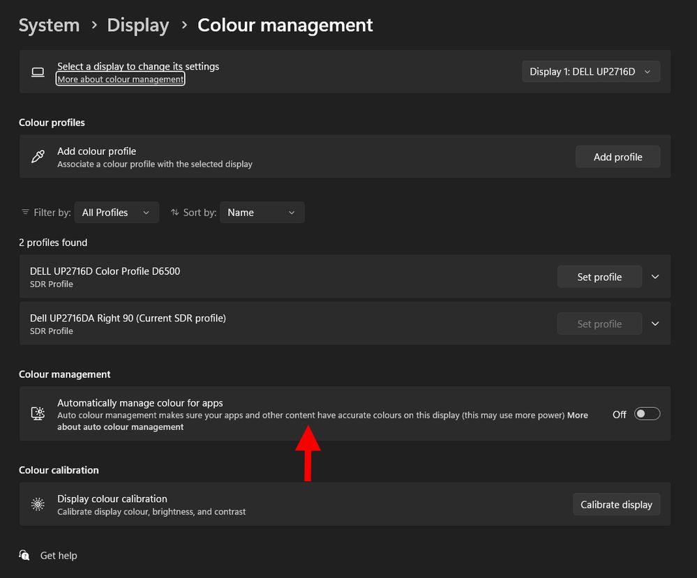

Hang on. This is odd. I took a closer look in Windows settings, and it turns out there is no checkbox for "automatic color management" at all. From other screenshots I've seen, it should be here:
Yes, this is Windows 11 24H2, updated about a week ago.
Could this be tied to HDR-capable displays? Mine isn't.
Or could it be that this is actually not about the monitor profile, but the calibration tables? It wouldn't be the first time that distinction is misunderstood even by people who should know better. The Eizo I'm using has hardware calibration, meaning the calibration tables are not loaded in the video card, but internally in the monitor. None of this affects how the monitor profile is used, but the OS/GPU doesn't need to load the calibration at startup.
Here's the Color Management tab:
I actually have 4 monitor profiles that I switch between, but Eizo Colornavigator loads them into the OS as needed, so that only one is visible in Windows at a time. The point is that I've tested all these profiles and they all load correctly.

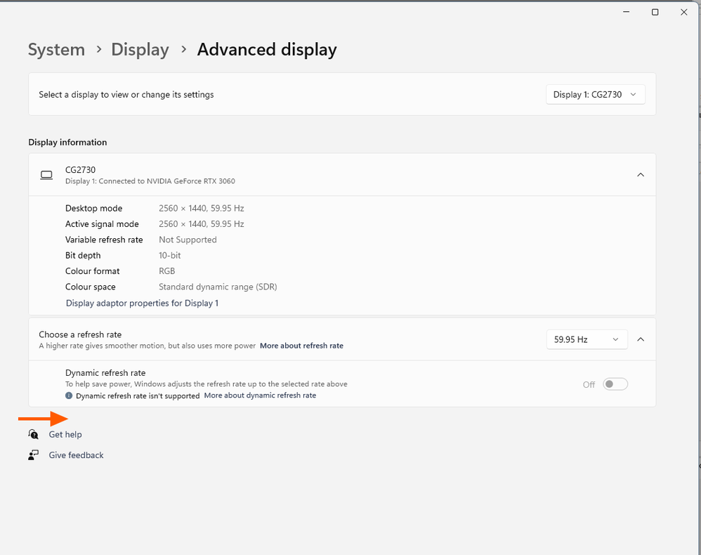

My analogous system settings look like this:
The switch for "Automatically manage colour for apps" is often shown in a different place in other screenshots.
Descriptions frequently say it is found under System>Display>Advanced Display which is where you were looking. In my case, it never was there - in fact it wasn't anywhere until 24H2 was installed and now it appears as in my screenshot.

Something else of concern about ACM that I have noticed is that, if enabled, NVIDIA colour settings are immediately changed so that Desktop colour depth is set to SDR (64-bit). Disabling ACM does not reset this which seems to be the reason that my dispays turned pink and distorted when I simply switched off ACM. I am forced to change colour depth back to SDR(24-bit colour) manually to restore normal service.
Came upon this from NVIDIA Support which explains (or confuses us) more. Datacolor say disable ACM but NVIDIA say keep it on!

If you don't have the switch, it's off and you won't have any problems. Everything works as it always has.
If you have the switch, turn it off. Ditto, you won't have any problems.
What's confusing is why some have it and some don't. But the purpose is apparently to aid with applications that don't support color management. That's really not a critical concern.
Just leave it off.
