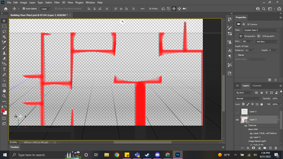

Hello!
I'm trying to make a 3D floor plan and when I used 'extrusion from selected layer' it doesn't follow the path that I drew. The red line is the path I would like the extrusion to follow, but it seems like Photoshop has it's own ideas.
I'm using version 22.4.3, but I have access to some other versions through creative cloud as well. I used the pen tool to draw the lines. I dug through some threads trying to find the right answers, but no dice.  I uploaded a .psd file with just the lines, but I can upload the 3D one I'm struggling with right now. Is there anyway to fix this problem?
Thank you so much for your time!! 🙂

Hi
3D features are been discontinued in Photoshop, you can either try enabling Deactivate Native Canvas in version 22.4.3 or install version 22.2
https://helpx.adobe.com/ie/photoshop/kb/3d-faq.html

Hello! Thank you for taking the time to reply.
I just downloaded version 22.2 and I am still having the same rendering issues
Do you have any other ideas? 🙂
Aug 31, 2022 Aug 31, 2022
Did you extrude from a pen path, or just from pixels drawn with the pen tool? The pen path should be more accurate.

Hi Dave!
I was using shapes drawn by the pen tool, because it seemed more accurate to me. I used the pen path this time and it's about the same
I used shift+click to keep the lines straight?

For the first one I used the pen tool to draw the paths and filled in those paths with the foreground color, for the one I just posted, I stroked the pen tool paths with the brush tool

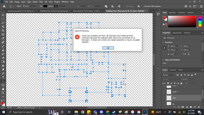

First, I tried closing the door ways a little to see if that would force photoshop to follow the lines better, but I was told the drawing was now too complicated to extrude from.
Second, I went through and made all of the lines consistent, kept the door ways tighter, and made sure there weren't any pixels bleeding over. They still taper anways?
I didn't see any bleed over when I zoomed in..
I'm not sure why it's acting this way haha. Is there anyway to tighten the walls at all? or move the blue line that outlines the 3D shape?

Try using a path (not pixels) to outline the red areas and then use 'New 3D extrusion from Selected Path'  rather than from the layer.

Hi Dave!! I'm sort of self taught in photoshop, I made a bunch of paths with the pen tool (using alt+click to start a new path while the old ones are still there), but they aren't connected together entirely. Is there a way to combine them? Or is this something I should do chunks? (ie the main outline on its own and the rooms in the middle have their own paths) Rather than one solid 3D figure?

I'm just not sure how to get all the wall details with one path
Sep 02, 2022 Sep 02, 2022
Hi
You need to draw the path around the walls. That way each wall is not a single path but has thickness.  A single path line cannot be extruded, but a rectangle made from four path lines can.
As an aside, unless this is just a one off exercise, I would not be putting time into learning this in Photoshop. As mentioned earlier, 3D in Photoshop is dead. Using a proper 3D application, such as Blender 3D, will be easier and give much better results.
