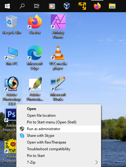

See if right clicking on the ps7 shortcut and clicking on Run as administrator makes any difference.
In the Start menu right click on the Adobe Photoshop 7 shortcut, then More and Run as administrator
Community Beginner ,
Mar 30, 2022 Mar 30, 2022
Jeff:
No, sorry that doesn't work. It tries to start and when the splash screens comes up it get the "Sorting Font List" and then it quits. Not sure if that helps or not but I really appreciate your tenacity on this!
