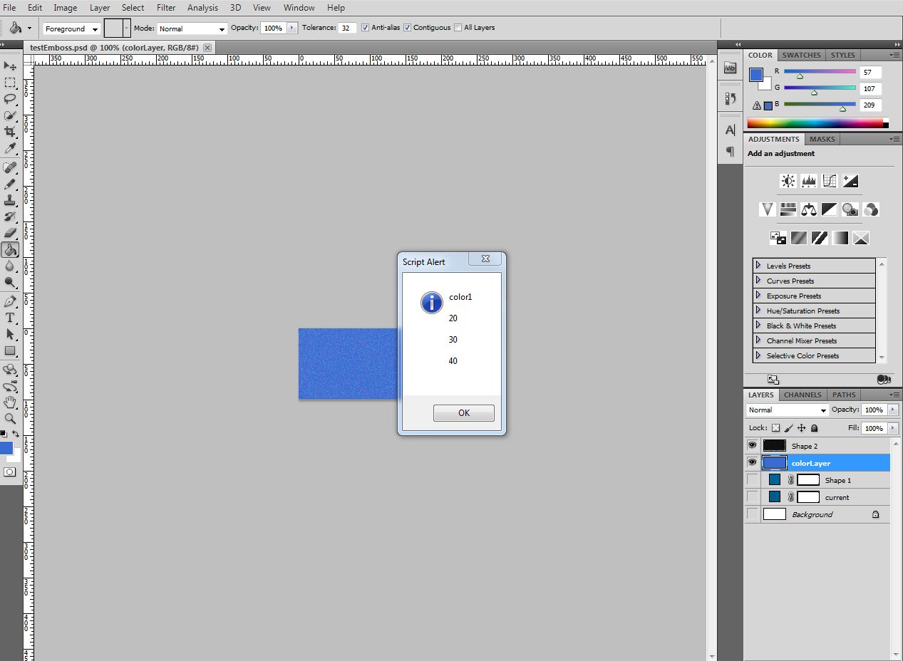

Thank you. I think this script will work, if I could get it to work on my end - having a little problem with that, though.
I took the code you provided and made a .jsx file out of it. I renamed my psd testEmboss-psd (also tried testEmboss.psd - not sure if it mattered). I made a new layer with the name colorLayer and gave it a flat color with the paint bucket tool. I also created a list.txt file with the values, identical to how you have it.
I tried to run the script by going to file>scripts>browse and selecting the .jsx file. It then instantly asks me for a text file, and i open list.txt. The only thing that happens at this point is a white alert box which seems to give me the first line of the txt file (double spaced). Any ideas?Capture.JPG
Guru ,
Feb 20, 2012 Feb 20, 2012
Did you OK it… If you don't want the alert then remove the line…
alert (thisText.join("\n\n"));
or comment it out with
//alert (thisText.join("\n\n"));
New Here ,
When I hit "Ok", nothing seems to happen.
I tried commenting out the alert, and now nothing happens at all, no alert, nothing. Nothing seemed to happen except the alert before, but now nothing at all seems to happen at all.
How often do I need to point out »Solid Color Layers«?
According to your screenshot you seem to have named a normal Layer »colorLayer« and not, as instructed, a Solid Color Layer.

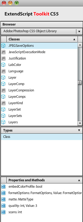

For figuring out how to save jpgs check out ExtendScript Toolkot’s Help > Object Model Viewer or search for a Script that does a JPG-save or refer to »Photoshop CS5 JavaScript Ref.pdf« and »Photoshop CS5 Scripting Guide.pdf«.
