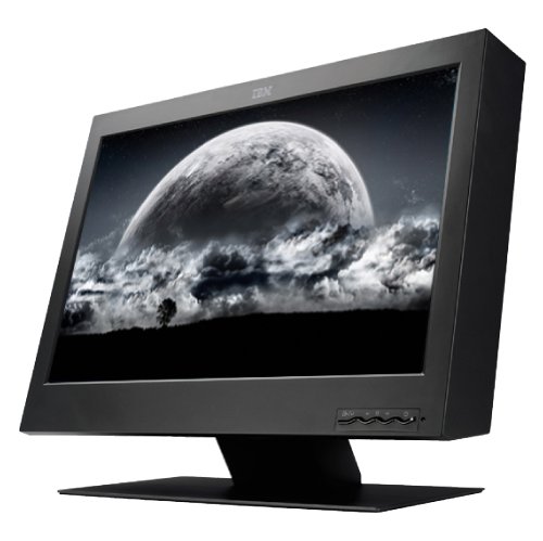

Hopefully by now your getting it. Oh and just reviewing the numbers if you happen to have an old IBM T221 display laying around you could display all the image actual pixels on screen. if to install it in a portrait orientation. The display displays 3860x2400 pixels 9.2MP. In portrait mode it would display 2400x3860 pixel your 2400x3000Pixel image would fit but because of the display resolution the image displayed would only be a 204DPI image.
Goodness! That's a serious display, and a new one on me. It doesn't look like it would easily stand in portrait mode, but I'm sure it would be doable
http://www.amazon.com/IBM-T221-22-2-3840x2400-Monitor/dp/B00006HS5R
A nice side benefit of the 1920 x 1200 display I now use for my second monitor in portrait mode (an idea that came from this forum), is that I can so easily drag a portrait mode image across to preview in much more detail, so this IBM beastie would be very impressive.

JJmack: please stop confusing dpi for ppi - there is a very fundamental difference, and it only confuses people when you keep using one for the other.
When you talk about the actual print on paper: dpi.
For screens and image resolution: ppi.
Pixels are not converted to dots in a one-on-one fashion in most cases. The fact that most people treat dpi and ppi as being the same things is bad enough as it is, and we should avoid doing the same thing on these forums, in my opinion.
That T221 screen displays images at 204ppi. There are no "dots" with screens, only pixels. And they are not the same.
