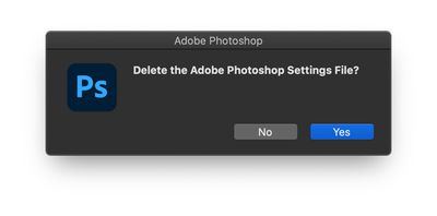

Hi Jane, thank you so much for your response! When I followed your instruction I got a pop up window saying "Delete the Adobe Photoshop Settings File?". Would this be the same thing as resetting preferences?
Jun 16, 2021 Jun 16, 2021
Hi @realleeee
Yes. It will look like this, but possibly in a lighter color.
~ Jane

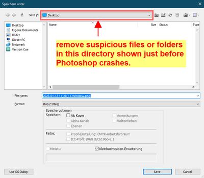

I had the same problem on Windows. I only solved it by removing a folder from the directory Photoshop was browsing within the "Save As" dialog when crashing. In my case it was the so called "God Mode" system folder.
If your crashes have a similar cause:
Try removing non-regular files or folders found in the directory shown in the "Save As" dialog when Photoshop crashes.
