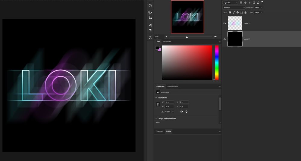

For some reason, when I try to export or save this as a PNG, the colours get dull. I even tried the sRGB, and the results are the same. Colour mode is RGB.

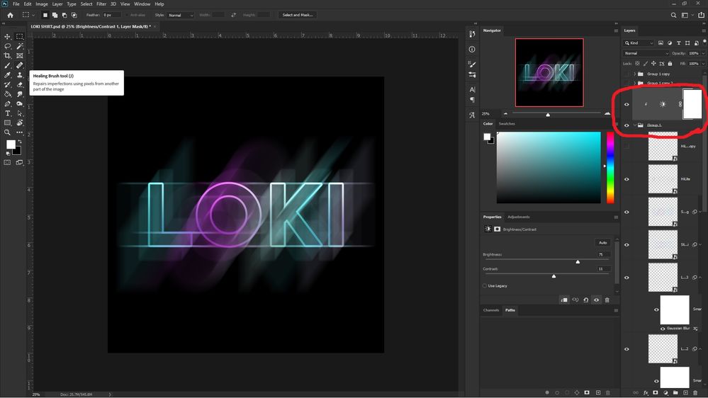

The first image is how I want it to look. The 2nd is how it turns out upon export. I was able to recreate that by merging all the layers. The 3rd is me assigning the adjustment layer to the group using the alt-key method, but it still fades the colours. This problem occurs in both PS2019 & PS2020.

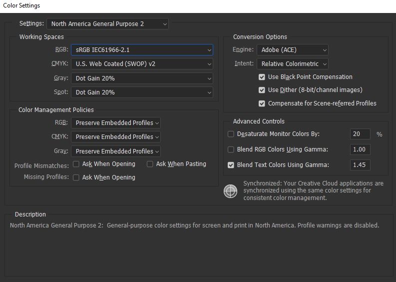

What is the color profile of your original? Exporting changes the profile to sRGB rather than Adobe RGB 1998 or some other higher gammut profile.

I doubt the colour profile is the issue. All 3 screenshots are from within the software. I was able to recreate the issue within PS. The problem seems to stem from the adjustment layer when all layers are merged (which also happens when an image is saved/exported), and moving it out of the group and reassigning to the group folder from the outside won't help either as shown in screenshot #3.

"I doubt the colour profile is the issue. All 3 screenshots are from within the software."
Every file has its own color profile, independent from each other. The embedded profile will always override your working space. So yes, you can have three files open and each is color managed differently.
If you don't make sure to embed the profile, you're throwing another wrench into the machine. In that case the result is completely unpredictable. The profile must always be embedded.
For some mysterious reason, Export does not embed the profile at default settings. You need to check the box to embed the profile, and to make matters worse, it doesn't stick. You have to do it every time.
So, once again: What are the color profiles of your three examples? Don't make any assumptions. Check.

1st screenshot is the file with nothing merged. The adjustment layer is inside group 1, but not assigned to anything specific. And all the colours are vibrant.
2nd screenshot is the same file with all layers (including adjustment layer) merged except for the black. I did not open a different file.
3rd screenshot is the same file with with adjustment layer taken out of group 1, dragged above group 1, then assigned specifically to group 1. The black layer is once again left out as its own at the end. Again, I did not open a different file.

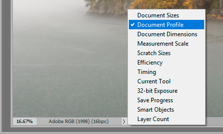

So already here we have a lot of variables. This isn't trivial. This is important! Don't brush it off. Here's how you check the profile:
Anyway. If you have confirmed that all three are indeed sRGB, and all have that sRGB profile embedded, then we can move on.

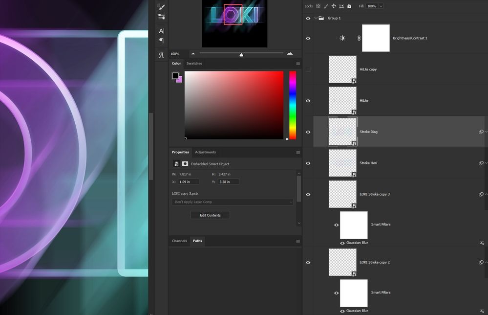

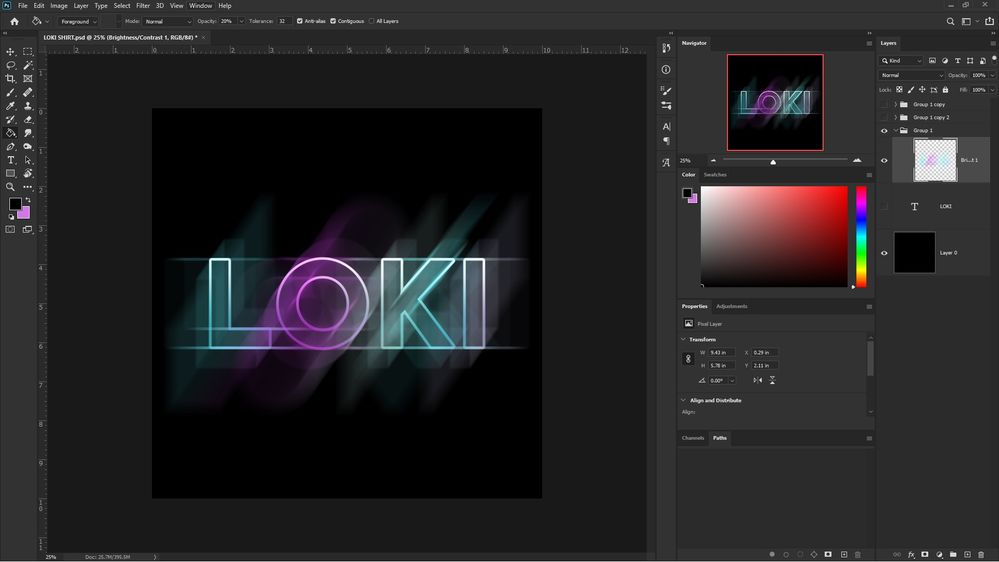

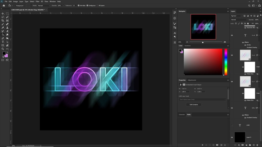

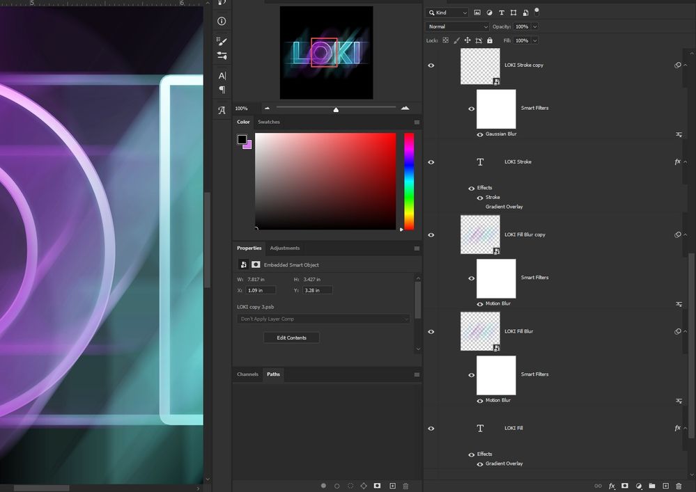

I've attached a close up of all the layers on the main PSD. Hopefully they show at your end.
As an extra, the last screenshot is the PNG on a black background after being reimported into Photoshop.LokiShirt3.jpgLokiShirt4.jpgLokiShirt5.jpg
