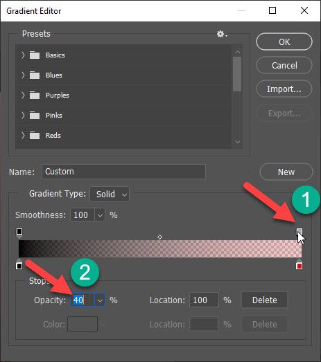

Community Expert , Sep 24, 2020 Sep 24, 2020
It is possible to decrease verticaly from 100% (upper part) to 40% (bottom part) ?
Take a look at screenshot below, click on right side Opacity Stop and set Opacity to 40%. Ensure that left side Opacity Stop is set to 100%.
Another option available to you is to use Gradient adjustment layer and to restrict gradient using layer mask.
