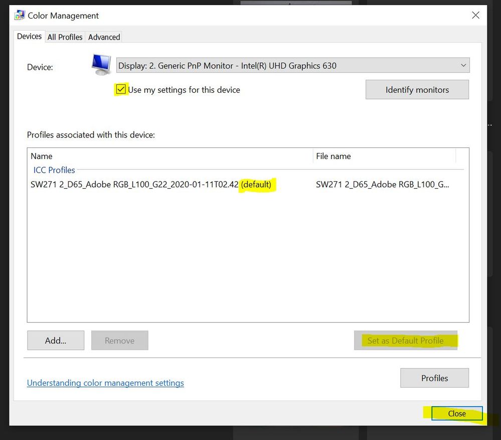

Have been troubleshooting why my prints are not matching my monitor. Prints are coming back from the lab darker and with a noticeable color shift. I am on a Windows 10 machine using 3 monitors. The monitor I use for PS is a BenQ sw271. I've calibrated my monitor, adjusted brightness etc. In the Edit>Color settings dialog and then Working Spaces>RGb drop down I am noticing that the Monitor RGB says "Monitor RGB - BenQ 2700". This is not the monitor I am using PS on. I am able to navigate (in windows color management control panel) to the profile that was established when calibrated and have added the profile and selected it as default. This has not changed the Monitor RGB in the Color settings dialog in PS. So, basically PS is using the wrong profile. How do I fix this so that PS uses the correct profile by default? (Attached screenshot of Color settings dialog for reference)

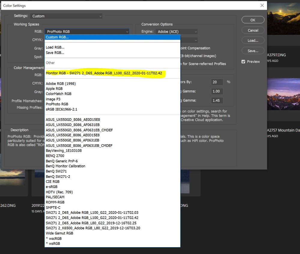

this can be frustrating, and it IS important to know that Photoshop does "see" (and, thus, use for image display) the right monitor profile in that list.
It seems the only way to be sure is to first set the display profile correctly in Windows then, because that's how PS picks up the display profile, Photoshop needs to open on the relevant display screen.
If it opens on the other screen drag it to the colourmanaged one, quit it and re open PS, with luck PS will now open and you'll see the right monitor profile listed there under available working spaces
Anyone reading this thread should be sure to note that the display system colour space (profile) is not to be set as the working space in Photoshop - that could lead to all sorts of problems

Normally this is entirely unproblematic. Photoshop will use the correct profile for whatever screen it's on. It doesn't matter where the application opens, and it doesn't matter where you move it. The correct profile is picked up once you drag and drop it across the 50% line.
That's how it should work, and that's how it works here (confirmed by testing).
EDIT: actually that's a bit inaccurate, because it's not tied to the app frame, but the image frame. You can have one image on one screen, and another on the other screen, away from the app frame - and they are both correctly color managed. Each using its own monitor profile.

Your working space is completely separate from your monitor profile. The monitor profile should only be set in the operating system.
Forget that you only see one of the monitor profiles in that list, it is irrelevant. If you want to check that Photoshop is using the correct system set profile for each monitor - set a profile in the operating system for one of the monitors that is completely inaccurate. The purpose is to throw off the colours on that monitor in a very visible way (I made an RGB Linear profile to test this).
Now drag the document window from one monitor to the other. You will see the profile switch for that document window when it gets past 50% content on that monitor. Drag it back and it will switch back. Now that you know it works put the correct profile back on the second monitor in Windows settings.

  • In Windows> Display Settings I changed the BenQ Sw271 to be the primary Monitor.
  • In Windows>Color Management Control Panel> Devices - I confirmed the display, confirmed the icc profile and then checked "use my settings", checked "Set as Default"
  • Opened PS which unexpectedly opened on my laptop screen. So, dragged it to the BenQSW271, made sure it wasn't maximized and closed out of PS. Re-opened PS and it opened on the BenQ SW271. (something I learned from another thread dealing with this issue)
  • Went to PS>Edit>Color Settings>Working Spaces>RGB drop down and found that the BenQ SW271 profile was now listed as Monitor RGB - SW271

To be sure - you do see the correct profile associated with each display in Windows Color Management?
