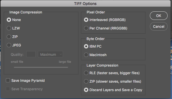

Step 3:  Select both layers, choose Auto-Align Layers (no blending), using the "auto" setting.
Step 4:  Export with the same file name to .tiff with these settings:
So that the final output image looks like this:
