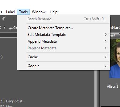

I installed PS 2017 and Bridge 2017.  Image Processor (and the whole Photoshop tab in Tools) did not appear in Bridge.  Reinstalled PS 2017.  No luck.  Reinstalled Bridge 2017.  Image Processor came back.  BUT THE NEXT DAY when I turned on computer, the Photoshop tab in Tools had again disappeared.  I followed the video instructions and manually removed the preference files.  No luck.  I uninstalled and reinstalled Bridge.  No luck.  Did the same with Photoshop.  No luck.  Very frustrating.
After that I uninstalled, then reinstalled both in different orders and said "no don't keep my apps" (or whatever it say).  No luck. More time wasted.

Explorateur ,
Nov 26, 2016 Nov 26, 2016
Your picture shows what I used to get.
This is what I now get:

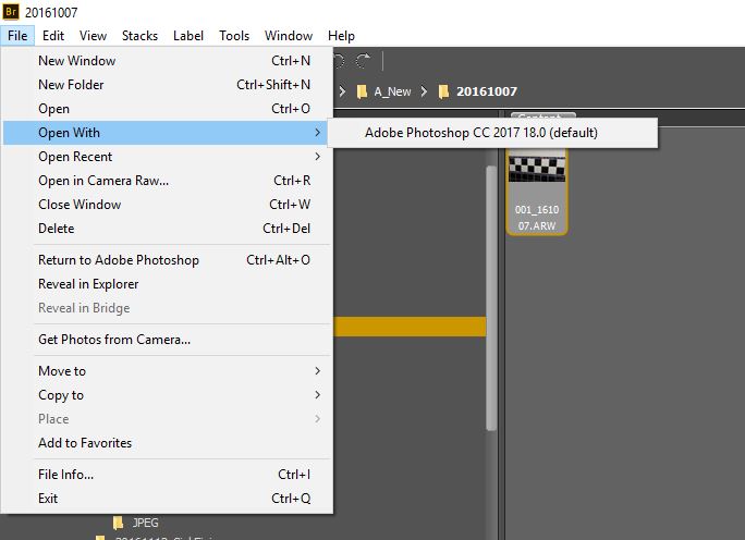

OK try this:
Right-Click on one of the images and Select Open With.  See this picture:
If you see Photoshop listed then click on it and see if it works.
This is to check whether Photoshop is correctly registered on your computer.  By uninstalling several times, you have made your machine unstable and so the only way to rectify this is to use Adobe Cleaner to remove everything before reinstalling again.

I did that and got the following.  It opened in Camera Raw and then Photoshop.  Mine says "18.0" as part of the Photoshop name.   Is that a bad thing?  Thanks.

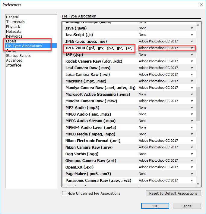

It's OK to have 18 as part of the name because it is version 18.  It looks like Adobe has different servers for different countries and so the products' interface is not synchronized.  I just checked my update history and it says everything is up to date - old and new so I won't be getting any more sleepless nights over this.
Any way so it looks like your system is working fine but your File Associations have disappeared.   I suggest open your Bridge again and then go to:
Edit >> Preferences
Then look for File Type Associations.
Create one or two like jpg and png (these are all in the list) and then "Browse" for the application to see if this recreates the entry that is currently missing.  The entry on your system will be None but there is also an arrow to browse for the application.  Try it.
Of course you need to create for all of them gif, tiff etc etc. and even PSD,  but first thing first.

Explorateur ,
So hopeful - but then I checked Preferences and it already has the associations (see below).  And Bridge has always opened files in Photoshop, just using "Open".  Thanks for your persistence.  I await your next suggestion.
