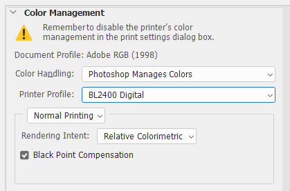

The monitor profile has one purpose, to display images correctly on screen. It should never be used for printing.
I'm not familiar with Canon printers, but I'm pretty sure they supply icc profiles for their papers.
In the Print dialog, first choose Photoshop manages colors, then select the correct icc profile for the paper/printer combination you are using.
In the Canon printer driver, select the paper you are using, and make sure color management is disabled.
If you are using a non-Canon paper, go to the paper manufacturer's website, and download and install an icc profile for the paper.

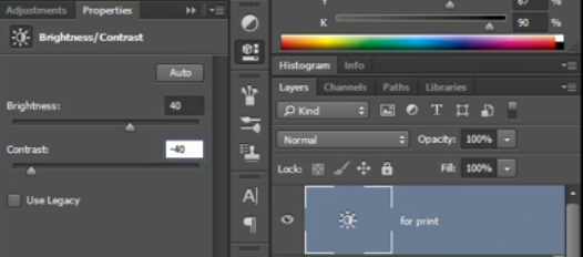

Here's something to try. The reason print colors differ from monitor colors is that you are dealing with ink piled on paper (reflective color), not direct color as from a monitor.
If you have set up things as previously advised, here's a trick that has helped me.
Add a Brightness/Contrast layer to your image before printing. Brightness +40/Contrast -40 is a good start.
Then print with that layer on and see if the results are any better.
