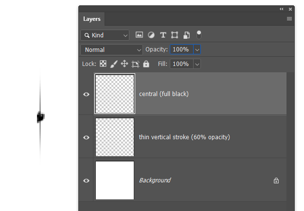

Community Expert , Sep 16, 2025 Sep 16, 2025
I have run into this problem before.  If you use an outer area that is blurred and lower opacity, it still paints fully black because each stamp of the brush overlaps.  So you need to make the shading part very thin like below, and experiment with spacing.  You also need to set angle jitter to Direction, which leads to another problem, that being spokes in the outer shading on tight curves.
Even with spacing set to 1% the spoke effect is still evident.
So maybe better to use layer styles
I
Adobe
If you want to devote more time to it, take a look at Dual Brushes.  A lot of Kyle Webster's presets work that way, so find something close and reverse engineer it.
