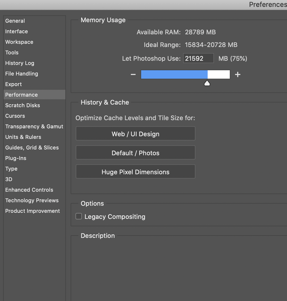

Other people with similar problems have reported that unchecking "Legacy Compositing" in the Preferences fixes it for them.

I tried that yesterday with no luck, I tried again now and it has fixed problem 👍thank you.

Thanks Rafael ! This was a bug that was causing me headaches, not only would it double place images but it was also effecting masking.  I could paint on the mask, but the effects wouldn't be shown unless the photo was turned on and off.   The advice you gave was correct and it fixed both issues.
