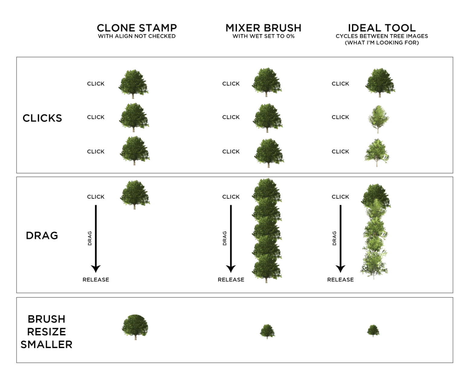

I have objects that I've created that have multiple colors that I want to lay on my background quickly. My current workflow is grab 10-20 layers of these objects at a time, reseize, and then move them to each location, control + clicking each one on the way to deselect it once it's in the correct spot. I do this Hundreds of times on each project.
What I'm looking for is the ability to lay these multicolored objects like brush clicks. I have explored the Mixer Brush which does exactly what I want aside from using the same image/symbol over and over. I'd like it to cycle through different images. Sort of an image brush that cycles through images in a set library.
I appreciate all suggestions. Thank you.
Below is an example gif of my current process that I'd like to streamline. (not actual project)
https://i.gyazo.com/0a3569312cc059ce60d770aef3429779.gif

I understand how that works. Those are all the same shape and also one solid color for each butterfly. Not what I'm looking for.

Yep, and all of that deals in one color at a time. The trees has lots of shades from green to yellone and brown stumps. Need multiple colors. Not just one like the brush in your example.

The only Brush type tool  I know of that can brush multi color object is the Clone stamp tool with align not not checked with a click you could stamp lay down multi color objects.  Brush controls like size hardness, blending etc may be useable.  However,  I sure many brush dynamics would not be operational because of the sampling nature of the clone stamp brush tip while stroking.  Strokes will only repeat the original source point with a fresh click.
