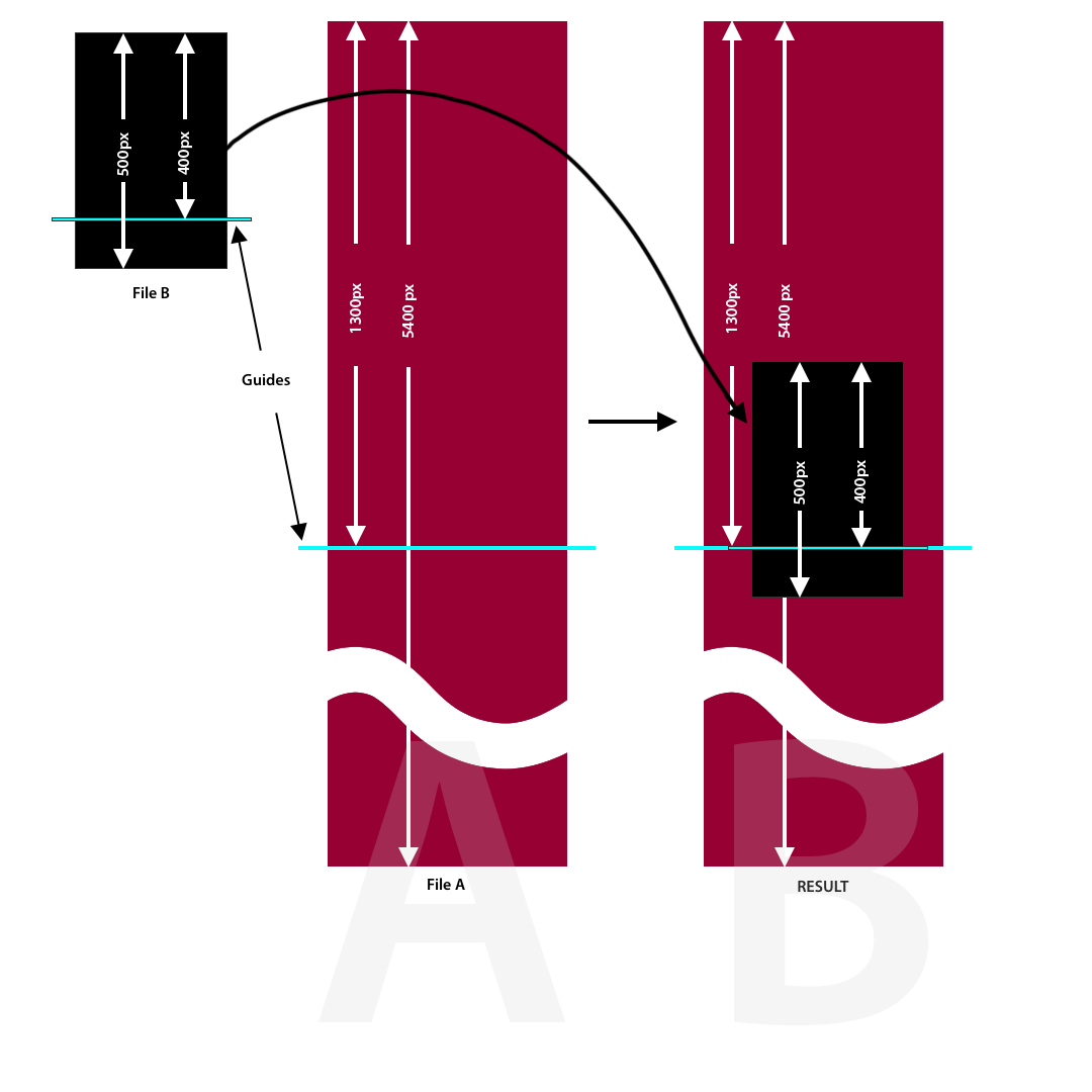

Thank you for your replies.  Perhaps I was not clear with what I need to accomplish.  The guides are only important because they indicate where the two files should be 'joined' but there is no requirement to save or preserve the guides at the end of the process.
Consider the following example, I start with 2 files - File A and File B. I need to open File B, resize it,  copy its only layer to File A, and then move the copied layer to a certain position.  tI have thousands of distinct File B files, some of which have a guide as illustrated below.  The guide can be anywhere in File B but it will always be horizontal.
File A also has a guide.  That guide is located at 1300px from the top of the file as illustrated below.  The objective is to place File B in File A in such a way so that their guides would 'match' as illustrated below.
The guides themselves are unimportant to the end result.  It doesn't matter to me if they cannot be preserved or saved with the file. The position of File B is what is important here.
I currently duplicate File B's active layer into File A, and then use the activeLayer.translate method to move the layer into position.  This works great but I just don't know how to determine where to move the layer if I have to make that determination based on where the guide was located at in File B.   This is what I need help with.  Does this make better sense?

People's Champ ,
Feb 28, 2018 Feb 28, 2018
Is this suitable?
app.preferences.rulerUnits = Units.PIXELS;
var doc_a;
var doc_b;
try { doc_a = activeDocument; } catch(e) {} // assume that doc_a is an active document or define doc_a and doc_b yourself
for (var i = 0; i < documents.length; i++) if (documents.id != doc_a.id) { doc_b = documents; break; }
if (doc_a == undefined) alert("Active document is missing")
else if (doc_b == undefined) alert("The second document is missing")
else
    var offset_a;
    var offset_b;
    activeDocument = doc_b;
    try {
    if (doc_b.guides[0].direction == Direction.HORIZONTAL)
        offset_a = doc_b.guides[0].coordinate;
    catch (e) {}
    activeDocument = doc_a;
    try {
    if (doc_a.guides[0].direction == Direction.HORIZONTAL)
        offset_b = doc_a.activeLayer.bounds[1] - doc_a.guides[0].coordinate;
    catch (e) {}
    // duplicate layer from doc_b to doc_a
    doc_b.activeLayer.duplicate(doc_a.activeLayer, ElementPlacement.PLACEBEFORE);
    // translate layer to position
    if (offset_a != undefined && offset_b != undefined)
        doc_a.activeLayer.translate(0, doc_a.activeLayer.bounds[1] - offset_b - offset_a)
    else
        alert("Position is undefined!");
P.S. was edited
