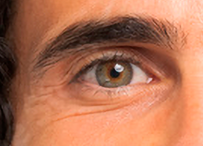

As for upsampling - there is no systematic way to confirm an upsample in PS, but you should be able to tell when you zoom in at 100%  the quality would be less if improperly upsampled.
Here is an image at 100% 100 ppi:
Here is the same image at 100% upsampled to 300 ppi:
Heres the image not upsampled at 300 ppi (purchased a larger version)
Note the quality in the details and color it's fairly obvious when upsampled.
