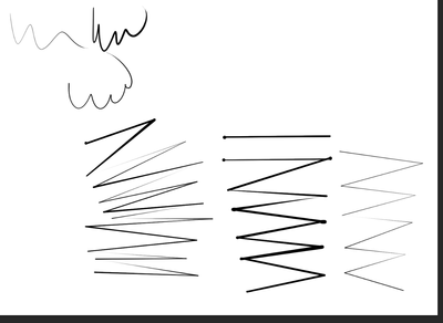

Using the Hard Round Pressure Size brush and default tablet settings (using wintab in photoshop), when I press hard on the tablet only a tiny little dot appears. It isn't until I move the pen (still pressed down on the tablet) that Photoshop registers the hard pressure and gives me a larger stroke. So it seems to me that Photoshop is taking the initial input of when the nib touches the tablet to determine the size of the stroke/dot. This is fine when I am drawing regularly but when I shift click it doesn't take into account the pressure in which I press at and only gives the initial reading of the pressure (which most of the time is going to be really low because when the nib bearly touches the tablet it isn't at a high pressure). Perhaps this is an issue which how often the tablet or Photoshop updates the pressure reading, since there are a few times where the stroke comes out big (but this seems random). This would never happen with my wacom but I seen past threads about this with wacom users.
Attached is an example of how the shift + click operation is behaving.The big dots at the end of the stroke come out because I move the pen just ever so slightly after pressing hard.
