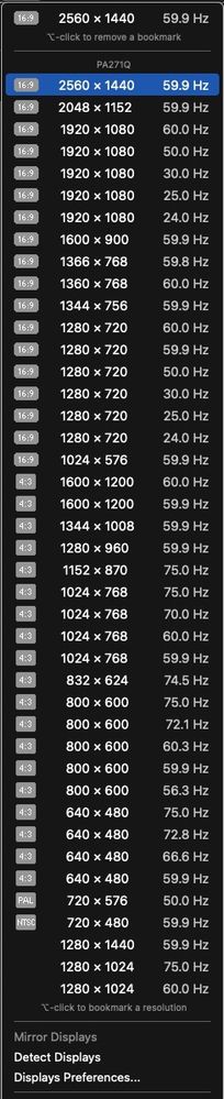

To change an image's size on a display you need to scale it to a different size image and display the scaled version.
And the resolution game begins again:
