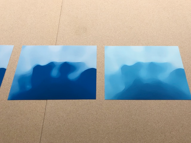

In addition to Jim, many other photographers are having issues with print colors in MacOS Catalina. I have not seen a pattern yet, other than incorrect colors. Some have magenta shifts, others just color shifts across the spectrum. It seems to be an issue with color management in Catalina, as it is showing up in CC 2017 thorugh CC 2020.
Jim's print settings are correct, and the the ICC profile for Canson Aquarelle on the PRO-100 prints accurately from MacOS High Sierra 10.13 and before. To troubleshoot, we took Jim's file, opened in Photoshop CC2019 (on MacOS High Sierra) and used Edit>Convert to Profile to convert the file to the output (print) profile. The file was saved as a TIFF, and then opened in Adobe Color Printer Utility on Jim's computer and printed. ACPU bypasses any OS or Adobe color management, something no longer possible in PS or LR. The print from ACPU was accurate to the screen, not showing any of 'blue bleed' in the PS prints.
Original image on the left, printed from PS in Catalina
ACPU image on the right, printed in Catalina
Hopefully Adobe/Apple can find and fix the issue.
-Evan Parker
Canson Infinity Support

Hi All,
This new test, I think proves that there is a problem with the Catalina OS in relation to the Photoshop.
The photo on the left is my image printed with from a Mac Book running the Catalina OS and the Canson print profile. Note the dark blue "bleeding". The one in the middle is the .tiff image that Evan created per his post above then sent to me and printed on my Canon Pro-100 via the ACPU. The one on the right is my image that I uploaded to my Creative Cloud account, then opened on a MacBook Air running the High Sierra OS and printed using the print profile from Canson. I am happy with the results, the dark blue does not "bleed".
I do not have another computer with Windows to test but to me it is clear that the "bleeding" blue problem is not the profile but way in which Catalina OS works or doesn't work with Photoshop.
I will file a bug report per Dave's suggestion and link this discussion to that report.
At least my work around is easy and I can continue printing my art without the laborious process in Evan's test above.
You all have been a great help. Many Thanks!
