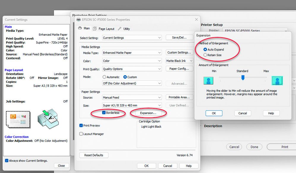

On most printers, selecting 'Borderless' printing results results in a slight scaling up of the image. That is to prevent white edges showing if the paper is slightly misaligned. I don't know about their Mac drivers but on Epson's Windows drivers, when choosing borderless there is an Expansion option, which can be set to Autoexpand or Retain Size. Retain size stops the scaling but at the risk of those white edges showing.
This is why many commercial prints are made with a bleed area, i.e. an extra area of image around the print, which is trimmed off when the paper is cut to final size. That allows for any misalignment in the printing process.

@Steffen Dyhrberg See below from macOS Ventura Epson driver, click on 'print layout settings for more info on scaling'

@davescm "On most printers, selecting 'Borderless' printing results results in a slight scaling up of the image. That is to prevent white edges showing if the paper is slightly misaligned. I don't know about their Mac drivers but on Epson's Windows drivers, when choosing borderless there is an Expansion"
Yes, same on Macs and I don't think it's an option either, on many printers slight expansion just happens in the background.
For many the only way to get bleed prints is to print on oversize media and crop.
@Steffen Dyhrberg I suspect 'scale' is not at 100% in the printer settings, please post dialog boxes (not fullscreen images) inline in a reply so we can check.
