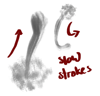

I just upgraded my MacOS from Yosemite to High Sierra so I could use the latest PS verison.  Since then, brushes are giving me hard "blobs" of paint at the beginning of the stroke even when my stroke is super soft pressure. See below. Anyone know of the cause and fix?  Thanks in advance.
I simply can't paint with this. The artwork looks terrible with all these blobs.

I just removed the Wacom Driver and reinstalled it. It seems to be working fine for now.
EDIT:
OK. This is frustrating. This KEEPS happening. A restart helps, but it keeps happening again and again. Restarting a few times a day is counterproductive.
Anyone with advice?
Thansk!

The same thing happens to me on OS X Catalina. All driver reinstalled. No Luck. Very frustrating with texture brushes. It works fine on fast strokes.

I've had some luck in Photoshop by turning OFF the airbrush button in the Options Bar.  Of course, this doesn't help you if this is an essential toggle for your art.

This has been my issue except the reverse is happeneing. When pressure is used to change the size of the brush it leaves a blob at the very end of the brush stroke. It's extremely frustrating. It has been happeneing since the last 2 updates.

I solved the problem myself:
Systemeinstellungen, Wacom Tablet... Optionen... Spitzenausrichtungsassistenten deaktivieren!!!
(Google translation: System Settings, Wacom Tablet ... Options ... Deactivate Tip Alignment Wizard !!!)

Nice find Brigitte5E75! Tip Alignment Wizard is not a feature in my Wacom settings options, but Tip-Up Assist is. Turning that off solved the issue. Thank you!
Sysyem Preferences > Wacom > Options > un-check Tip-Up Assist.

This is a life saver! I almost went nuts trying to fix this with the normal settings. For me if was happening while lifting the pen. THANK YOU for your help.
