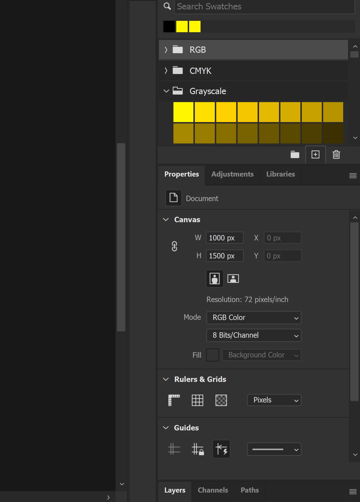

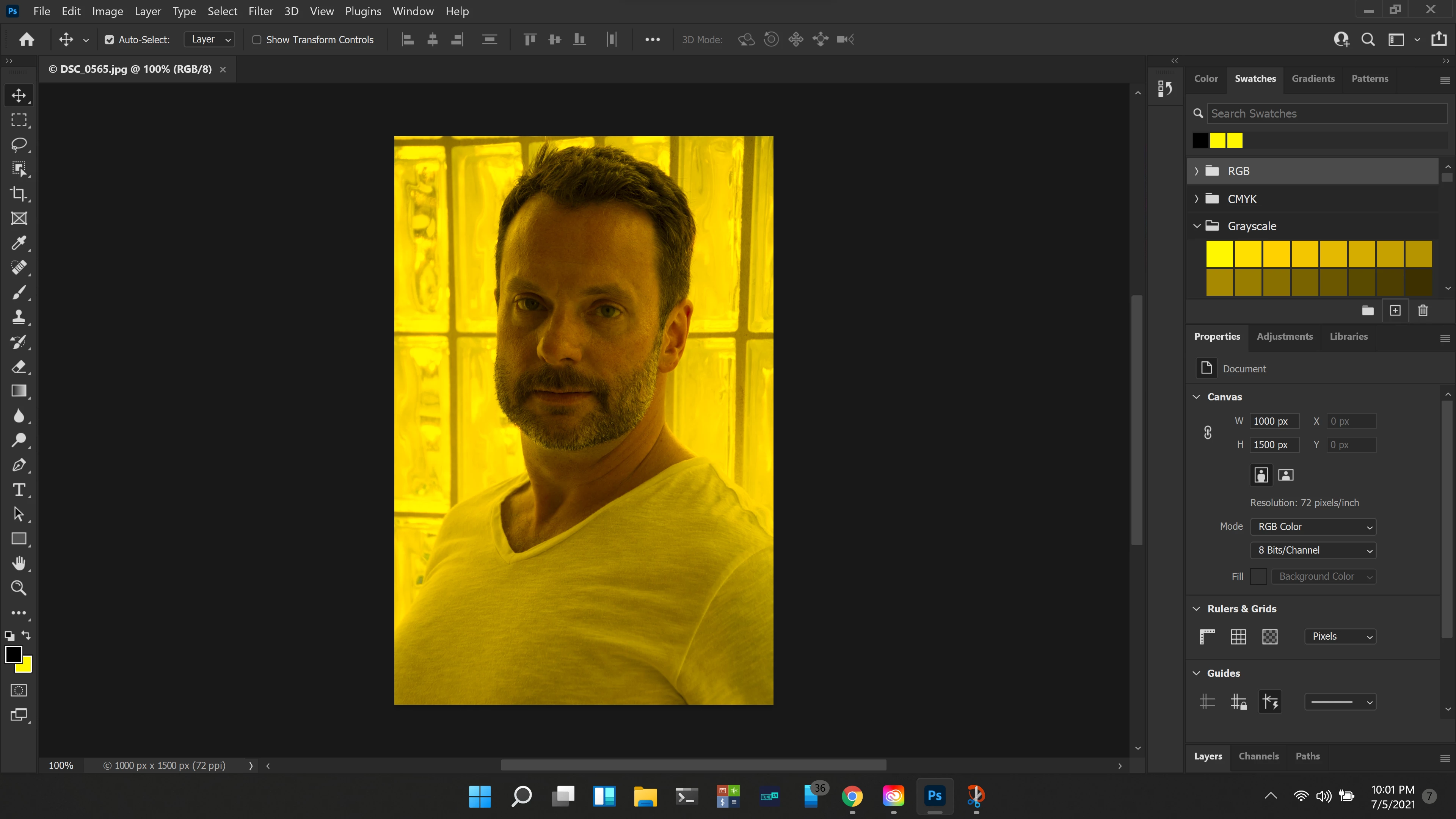

I have just discovered this issue and have been searching for asnd applying every solution I have found in these forums and online in the wild.
In Photoshop CC2021, white has been replaced with yellow. Not a dingy yellow, like a bad color profile, but a bright yellow.  I have included screenshots below. I have gone through and followed all the different advice from changing the monitor color profile management to sRGB EIC61966-2.12, restarted bnoth PS and laptop.I have tinkered with Color Profiles in PS settings. I have triggered the Reset Preferences on Exit and have tried to manually reset the background / foreground colors, but with white showing as bright yellow, that's all I get.
I have uninstalled and reinstalled the app numerous times, each time removing preferences, only to have the same yellow where white should be. I have recently upgraded to Windows 11 beta test but I cannot think of anything else that has changed since this happened. I am at a total loss for an explanation and unable to change the yellow back to white.
I am on an HP Spectre x360 15 eb0-xxx (2020) with an Intel inegrated graphics unit and an Nvidia GeForce GTX 1650 Ti with Max-Q Design GPU for the heavy lifting. As stated above, I am running a beta of Windows 11 on the latest build of Windows 10.
Thank you in advance for ANY help you can provide!
Marc
