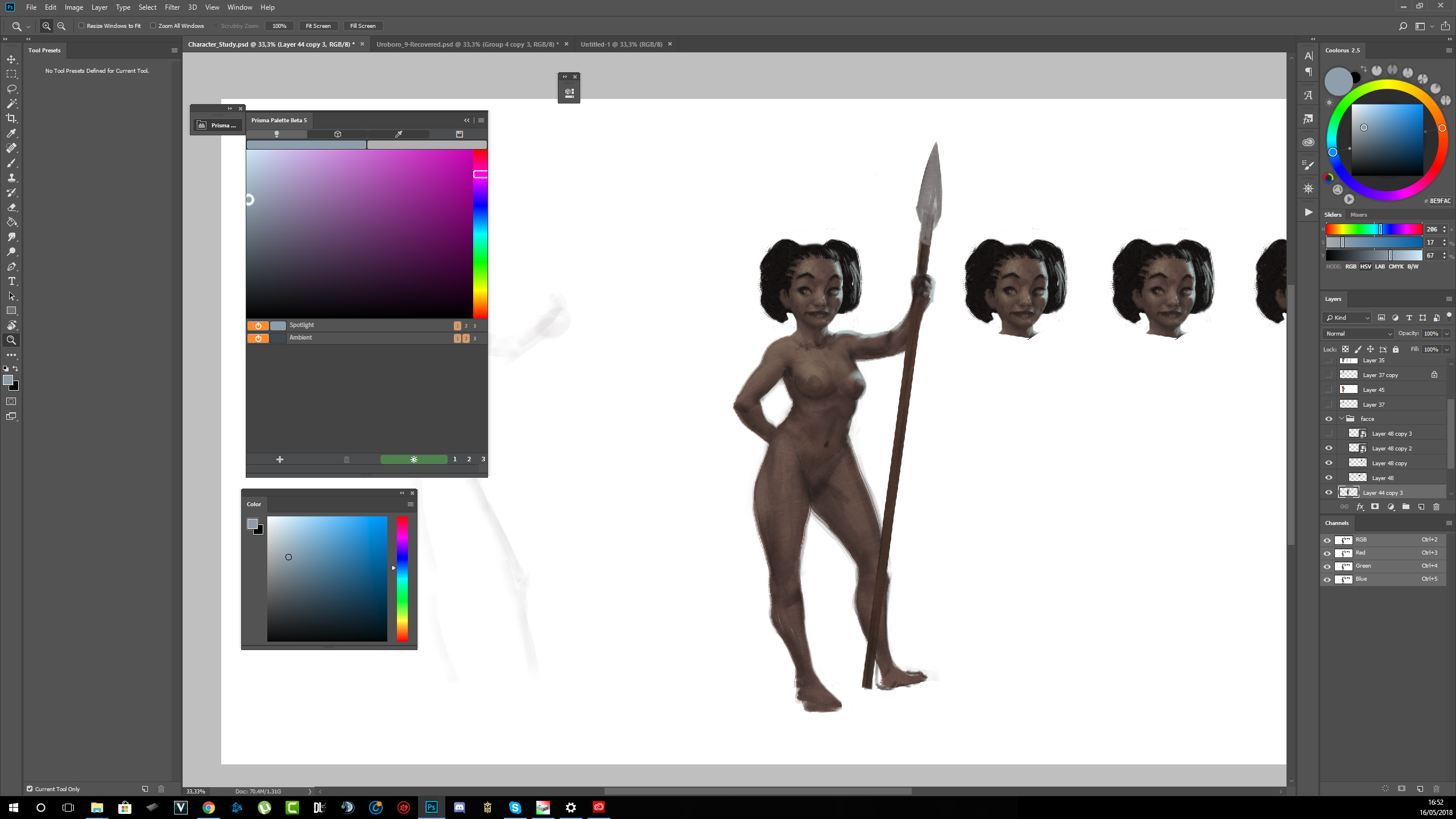

Take for granted that puppet warp does not work because of some software problem.
You have provided insufficient data to verify your claim.
What are the image’s Color Mode and bit depth?
Could you please post a screenshot with the pertinent Panels (Layers, Channels, Options Bar, …) and dialog visible?

Could you please post a screenshot with the pertinent Panels (Layers, Channels, Options Bar, …) and the menu visible?

May 16, 2018 May 16, 2018
I meant that menu:
Hi
You are shown as having two GPUs (Intel and NVIdia) which will have different drivers. This is known to cause issues with Photoshop. Photoshop works well with multiple monitors (I use three) provided those monitors are driven by a single GPU.
See sections 7 and 8 here:
Troubleshoot Photoshop graphics processor (GPU) and graphics driver issues
Dave
Are you saying Puppet Warp is not available after putting the selected area on a transparent layer?
Explorer ,
Yes, transparent layer, and no Puppet Warp available. I think it's something related to GPU acceleration as well as the AIF error during Liquify.
It seems to me like PS is not using my GPU even when I select the option in the Edit>Preferences window, and I don't know why, or how to fix it...
