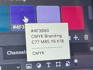

This is the swatch. I'm in CMYK mode. Let me know if you need to know more.
Jan 06, 2023 Jan 06, 2023

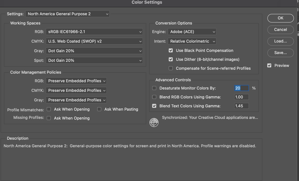

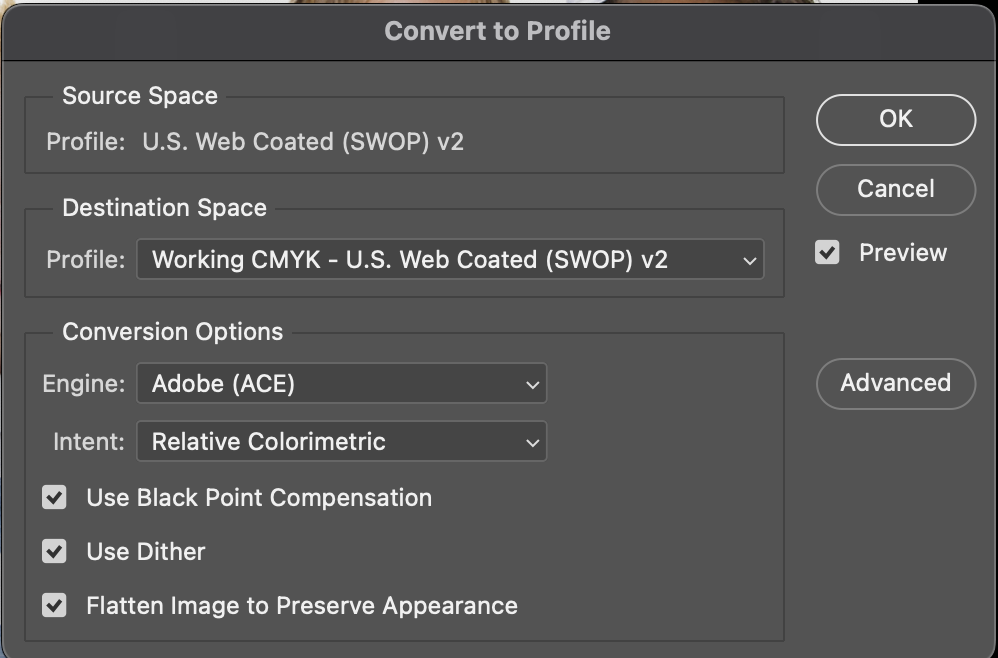

What CMYK ICC profile is assigned to the document, or what CMYK ICC profile is set in colour settings to be assumed for CMYK documents that are not colour managed with an explicit profile?
Community Beginner ,
Is this what you are looking for?
Screen Shot 2023-01-06 at 5.06.31 PM.pngScreen Shot 2023-01-06 at 5.04.36 PM.pngScreen Shot 2023-01-06 at 5.07.35 PM.png
Thanks, yes, the CMYK values when coupled with the U.S. Web Coated (SWOP) ICC profile do produce purple, the device independent Lab value are:
30L 22a -36b (relative)
30L 17a -27b (absolute)
This reflects the higher magenta over cyan value, however, we need to know the CMYK ICC being used.
It will depend on the software being used for printing, most consumer/office orientated software has no idea what CMYK mode is or what an ICC profile is, let alone a CMYK ICC profile – so any CMYK data may be converted to RGB before printing and without the correct understanding of what the input colour is, the output is wrong.
