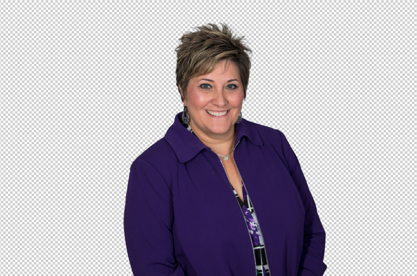

Working with 21.2.4. Attempting to refine hair. The following steps previously worked for me:
1.) Select > Subject
2.) Create Layer Mask
3.) Select > Select & Mask
4.) Using Refine Edge Brush Tool, I feather out to the edges from inside the hair.
5.) Output To: Layer Mask
For whatever reason, when I do this now, I get a whitened, almost grey hair look to the subject's hair instead of a refined edge on the hair. What am I missing? Any help is appreciated. Thank you.

I appreciate the reply. I did try your suggestion. The problem is that the hair I want to reveal/refine is still currently outside the mask.
Forgive me if this goes against etiquette, as I'm new here. I previously used this YT tutorial:
https://www.youtube.com/watch?v=cSXKTXQI3HI&list=PLpzWhOWVMAYLvW4Tao9TOacfvIuNmzPed&index=4&t=234s
At the 4:38 mark is what I'm trying to do. In a previous release of Photoshop, I was able to do this without issue. This time around, I cannot duplicate the result to save my life - even when I keep the brush tool small, as you suggested. In a new project, for example, I'm trying to pull out fine details in the hair and the beard, and I'm getting the same problem. It doesn't reveal those fine hairs.
