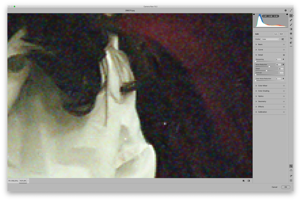

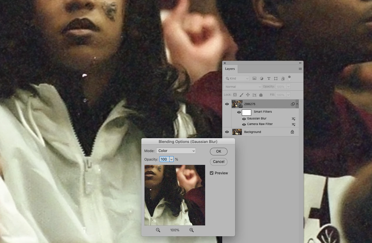

You could also try the Camera Raw Filter and, if necessary combine it with Gaussian Blur set to »Color« to address color noise separately (see screenshots).

Apply the Filters as Smart Filters, that way you can change the settings later on without unnecessary image degredation.
