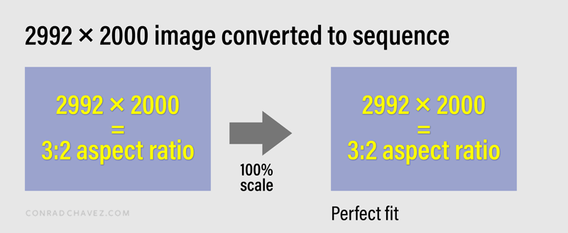

Some of this might be cleared up by seeing what happens in this animation, where all frame sizes are shown 1:1 relative to each other:
Again…ppi never comes up in the problem or the solution. In fact part of the reason there are problems is because of introducing ppi into the math. Because again, to understand size with pixels per inch, you have to say what the number of inches are on output. But there is no number of inches in video – you will not find any place in any video editor to enter inches or ppi – so anything involving inches is a wrong turn that does not lead to a solution.
You should see that what solves the problem is first stating the target final frame size, which appears to be 3840 × 2160 4K. Once you have that, you know all your original media must meet or exceed both the width and height of that in pixels in order to fill the 4K frame. If the stills exactly match both the width and height of the video frame, that will of course also match the 16:9 video frame aspect ratio. Then, to accommodate enlargement, the required width and height in pixels of a still image must be increased proportionally to how much you are required to enlarge the still images in Premiere Pro.
