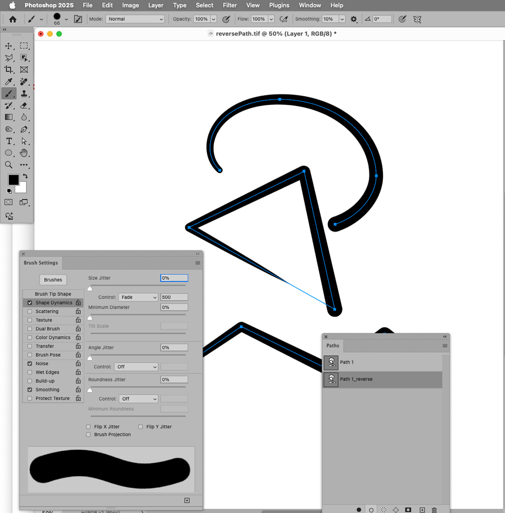

Jul 25, 2025 Jul 25, 2025
Are you talking about »Paths-Paths« exclusively or also Vector Masks?
Is the Path the active Path or are you trying to edit multiple Paths, Paths identified by name or some other property, …?
Engaged ,
paths as in path paths, not file paths, vector mask paths or a path in the woods.
These bad boys:
See what I did there 😄
// create a inverted version of the selected path;
// 2025, use it at your own risk;
if (documents.length > 0) {
if (activeDocument.pathItems.length > 0) {
var selectedPath = selectedPath2020 ();
var thePath = collectSelectedPathPathInfoFromDesc ();
if (selectedPath == undefined) {
var thePath = collectPathInfoFromDesc2023 (activeDocument, activeDocument.pathItems[activeDocument.pathItems.length - 1]);
var theName = activeDocument.pathItems[activeDocument.pathItems.length - 1].name
} else {
var theName = selectedPath[2]
// revert pathpoints etc.;
var theReverse = new Array;
for (var m = 0; m < thePath.length; m++) {
    var thisOne = thePath[m];
    var newOne = new Array;
    for (var n = thisOne.length - 3; n >= 0; n--) {
        newOne.push ([thisOne[n][0], thisOne[n][2], thisOne[n][1], thisOne[n][3]])
    newOne.push (thisOne[thisOne.length-2]);
    newOne.push (thisOne[thisOne.length-1]);
    theReverse.push (newOne)
// create path;
createPath2022(theReverse,theName+"_reverse")
////// collect path info from actiondescriptor, indices start at 1, not 0 //////

I think it should be possible to change the path itself, but I prefer creating a second one – a matter of taste (and laziness), I suppose.
You can reverse a Path using the Pen tool. With the Path visible, but no points selected, click on the beginning point to pick-up the path. Add a new point not on the Path, and immediately delete it. The Path will now be reversed.
Alas, with closed Paths that would be problematic.
But it reminds me of  one of the facets of Path handling where Photoshop is superior to Illustrator – pick up an inactive Path in Illustrator and you destroy the existing extending bezier handle.
Engaged ,
Jul 26, 2025 Jul 26, 2025
That's rather counter-intuitive, and wouldn't be something I would not have guessed at thinking. Assuming that the path's direction is initiated at which end it gets started at. Also it's not a menu item. Path > Reverse Path. and it doesn't work for closed paths.
Does the Script work for you or do you need the original Path to be edited instead of getting a duplicate?

Engaged ,
Jul 28, 2025 Jul 28, 2025
I get an error on line 4 (function collectPathInfoFromDesc is not a function
So I changed it to
var thepath;
might be collectPathInfoFromDesc2023 I'm not sure
The script didn't duplicate the path, but it did reverse it.
The function was in the previous Script.
