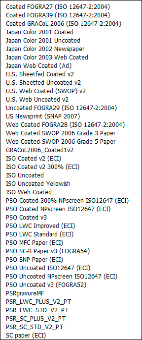

Then you need to ask which CMYK, and don't settle until you get an answer. The customer relations people often don't know; ask the people operating the press, or the prepress operators.
Take your pick:
Don't edit in CMYK unless you have a clear understanding of ink limits and gamuts. Work in RGB and convert at the end if possible.
The only reason to work in CMYK is if you have text or black ink areas that you want to overprint the other inks.
