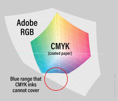

Especially if this is going to a press…Reproducing deep blue in CMYK is a classic printing problem that has existed for the entire history of CMYK printing, going back to its early days over 100 years ago. Unfortunately, Photoshop can’t address this basic problem (this is a problem you would run into with any photo software), because the root cause is that the color range that CMYK inks can reproduce is smaller than the range of colors you can get from paint pigments or on an electronic screen.
Keep in mind that every intense, apparently saturated blue you see in every CMYK-printed poster or coffee table book is likely a weaker blue than was in the original photo, or it’s more cyan than you think. If you open a professionally printed high quality art book with reproductions of paintings famous for their intense blues, you can bet that the CMYK blues that look impressive in the book are not nearly as saturated as the blue pigments in the real painting, because they were under the same limitation of CMYK inks. The only reason you never notice this is that you don’t typically have the original painting next to the book for comparison.
The picture below, made with Apple ColorSync Utility (which comes with every Mac so you can try this yourself), shows the color coverage of Adobe RGB compared to the profile for a CMYK standard for coated paper. If your job targets a CMYK profile representing uncoated or lower quality paper, the CMYK color coverage is even smaller.
