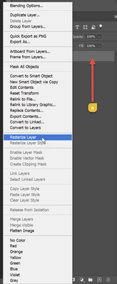

You need to right-click on the name part (a) of the layer.
By right-clicking on the image part, you get a different context menu.

Thank you! I think since I right clicked the layer which didn't give me the option to rasterize I didn't think about right clicking the name. I was so used to tapping the picture and it would just give me the option to rasterize that it caught me by surprise.
