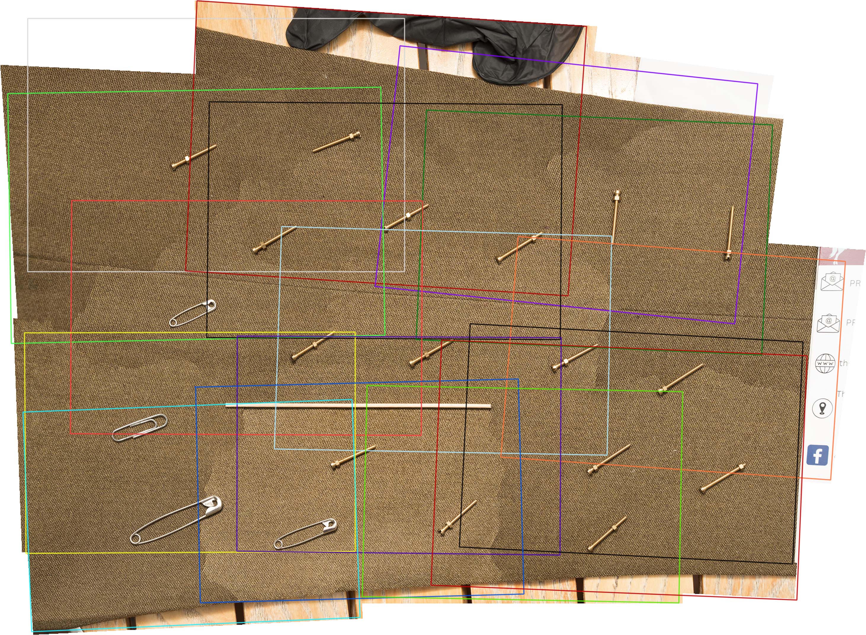

Hi, photographed a piece of cloth in a tiled way, with small linear objects laid out to afford kniting together ability visually, perp straight down, to get the detail of the weave, so as to knit it together in pshop to make a large piece if cloth for a website background, and despite bounce flash off a low white ceiling, giving apparent same looking cloth pics, Automate photomerge makes a bad patchwork quilt of lightness, worse than the photos appear to be. I had hoped moving from CS6 to 2025 photomerge would have an AI ability to even out exposures or hue etc in panoramas, but it doesnt. Surely thats par for the course by now ?

attached are three of the tiles and an overview of where the tiles were. clearly differing in lightness, just need to equalise the lightness, though having done that between two of them I could see a need for slight saturation change, if only photomerge had an option that allowed selection of a target pic and others were changed to match. I tried the edit auto align layers and couldnt get that to work.
My 1920x1200 monitor measures 20" wide x 12.5" tall and the trousers were about that for the area photographed.
