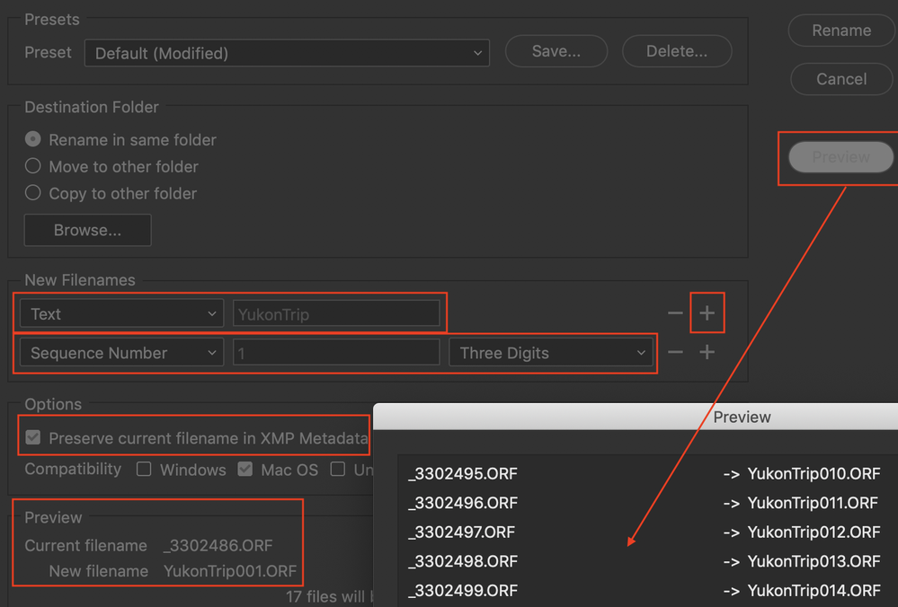

Hi Stacey, as mentioned i would use a file management program for this like Bridge in my case. and the steps are really straight forward
Select the files you want renamed, then select tools, batch rename... this will pop up:
Select the criteria you wish..

My answer is similar to Grant's, however, I have highlighted key areas of the interface:
EDIT: Sadly the poorly written forum software has resized the screenshot into illegibility.
