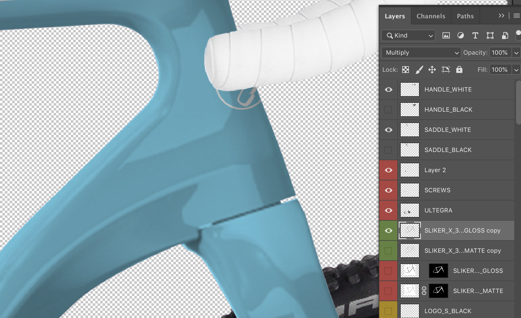

Hope this description help better to understand my problem.
I need to preserve the effect of having "multiply" filter on the layer. The background in this case is the light blue color - and it maintains the color true. See pic effect
The only way I understand I can save this layer id to save it with a transparent filter - although the picture contains white and makes the file "milky" and the background color is not maintained. See pic effect below

I wonder if the OP is confusing the multiply blend mode with transparency?
As in the solid  white layer in the screenshot below, allows the black circle on the layer to show through because the white layer is set to multiply
magnusa33778419   If you need a transparent PNG, just turn off or delete any background layers, and save as PNG.  When used in a web browser, they will retain the transparent background.
