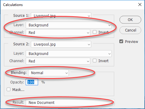

    This is one way:
    Use Image >Calculations to create a new document with just the required channel (e.g. here I've shown the red channel).
    In the new document change the Image mode from multichannel to grayscale
    Save As png
