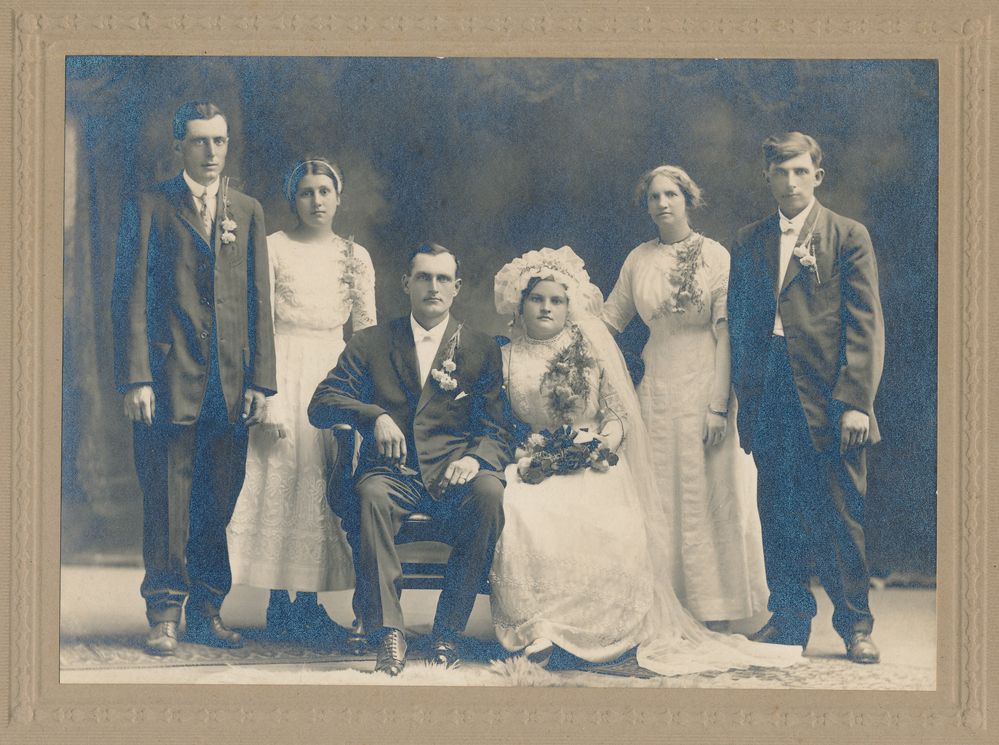

Similar issue here. The images are high resolution scan, *.TIFF, and 30-80 MB each. On several scans, the black ink caused a reflection. Is there a way to autocorrect?AustinJudy_0008a.jpgAustinJudy_0008.jpg
New Here ,
Jan 31, 2024 Jan 31, 2024
The above are JPEG, as required to upload here to chat.
Engaged ,
Sometimes you get the silver "comes out" of old prints and makes them reflective. Try rotating the print on the scanner bed, sometimes its better a certain way round. If you use a BW adjustment layer you can drag the blues and cyans to the left and make the darker, add a tint to simulate the sepia tone. You will lose the original sepia tone doing that way though.
Participant ,
Feb 01, 2024 Feb 01, 2024
This "silvering" in prints printed in real black and white photo paper is seen often here at the lab. It is caused by the leaching of latent silver in the emulsion; the silver is pushed to the surface.
Flatbed scanners have a fixed light position that is not ideal for minimizing surface textures and reflective elements.
The only way I have been able to greatly minimize this effect is by photographing the print with cross polarized lighting.
That is, polarizing the lights and lens in proper orientation to reduce the reflections from the silver.
