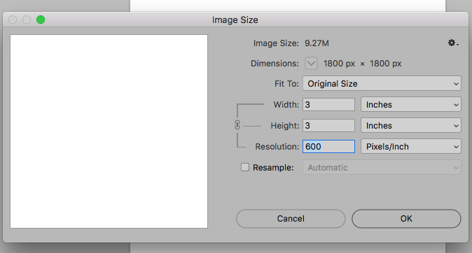

    One follow-up query on this. Quite a few of the older photographs I'm archiving are 3"x3". I've scanned in at 600dpi as TIFF, made any corrections required, saved and then also made a duplicate jpg version. I then decided to conduct a test by uploading the jpg to one of the popular online photo reproduction services and discovered that the smallest square sizing they support (like many) is 5x5.
    So this means I've got a 3"x3" image (as that's the result after scanning in at 600dpi) that's being upscaled. The two test photos I received back are ok but the quality is fantastic either so am wondering what else I might do to address this. Thanks

    digital_vibe : I overlooked the 600 dpi in your original post, it seems that the ppi value wasn't written to the file by the scanner.
    Photoshop will assign 72 ppi to files that don't have a ppi value.
    If the image contains the correct number of pixels, you can change the ppi under Image > Image size, with Resample unchecked.
