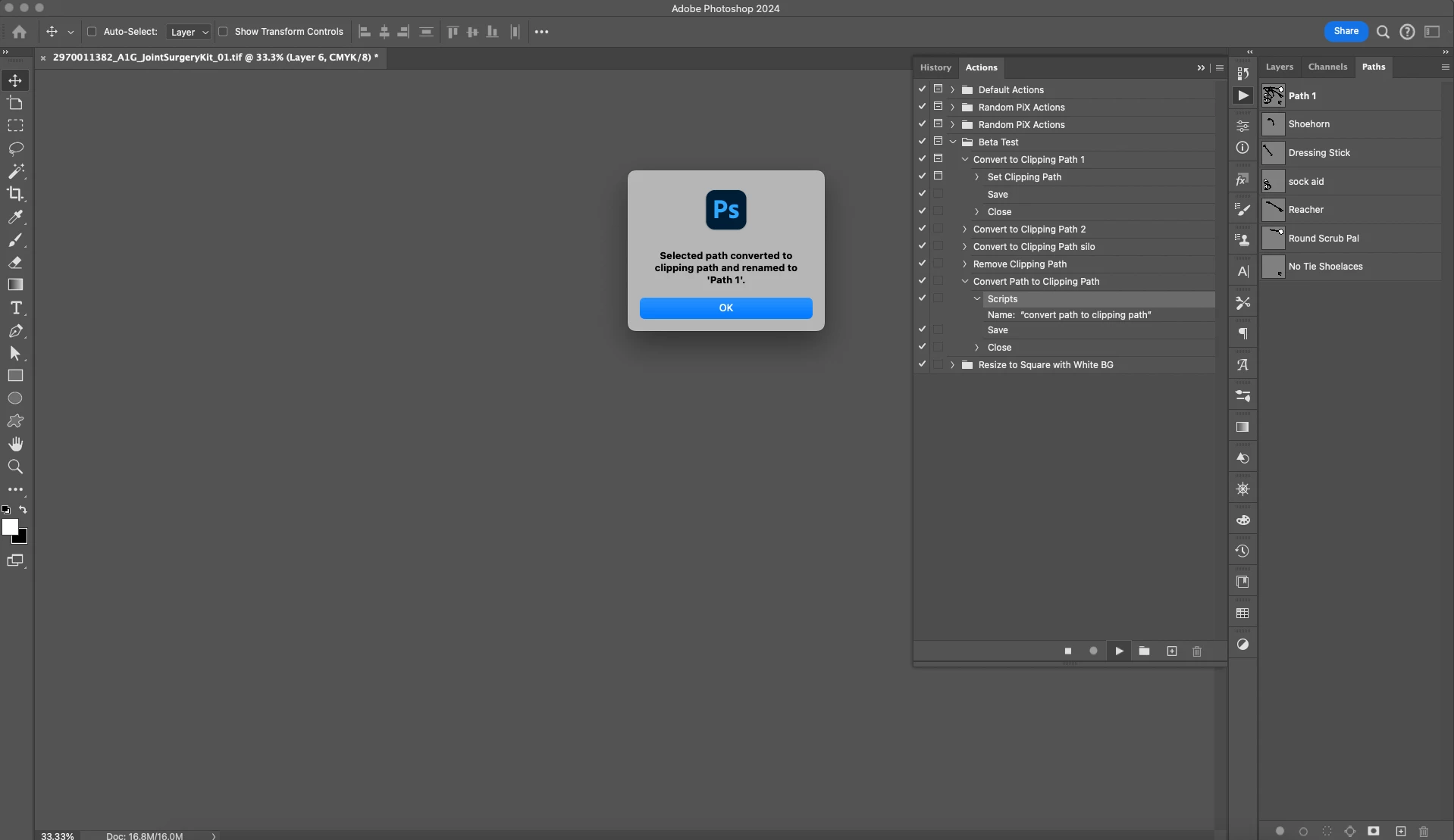

I created an action (I think correctly) where the script is run so that I could test it using File > Automate > Batch as well as File > Scripts > Image Processor. to some success and some failure so I have a couple of followup questions (highlighted in red):
  1. When I run it through Batch it seems to work but on every image it pauses and pops up a dialogue box that says "Single Path converted..." and I have to manually hit OK (see screenshot "Clipping Script_Successful Popup.png" attached—you can also see how the action I created is setup). Is there a way to suppress this popup so that it just runs through all files and does not have this pop up interrupt and need verification?

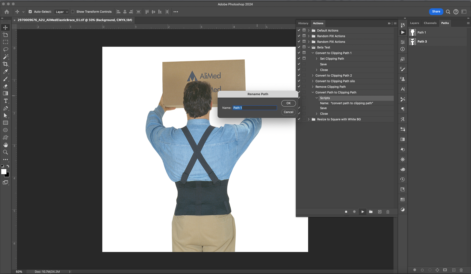

  2. I added another image to my test folder that already had a "path 1" in it and via the script "path 2" would be the proper one to rename to path 1 and convert to a clipping path. But you can see with the batch command I get this dialog box (see screenshot "Clipping Script_popup from Batch command.png"). If I rename it then the batch process will continue to run on the rest of the images (while still bringing up the "success" popup on each one). However, If I run this test folder through the Image processor with the clipping path action specified I get this popup (see and the screenshot "Clipping Script_popup from Image Processor command.png") and the whole automation comes to a standstill after that.  SO, my questions regarding this are is there a way to alter the script so that if it comes upon an image with multiple paths and one of them is already named path 1, but determines it is NOT the correct one to be the clipping path can it automatically rename the offending path 1 to something else, like path X (to ensure it's not anything that could possibly already be in the file) and then continue on renaming the CORRECT path to path 1 and doing the clipping path conversion? As a followup is it advisable to always use batch instead of Image Processor to run on a folder with an action that has a script embedded in it, given how it still kind of continued to work with batch but come to a complet standstill with image processor?

Stephen Marsh
Stephen MarshCommunity ExpertCorrect answer
February 21, 2024
quote
  1. Is there a way to suppress this popup so that it just runs through all files and does not have this pop up interrupt and need verification?
By @alimedi77729338
Yes, this is why I previously wrote:
"P.S. When batching, you will wish to comment out // or remove the 2 alert() lines from the script."
//alert("Single path in the document converted to clipping path and renamed to 'Path 1'.");
//alert("Selected path converted to clipping path and renamed to 'Path 1'.");
Or delete these lines, as they can't be suppressed by the Batch command.

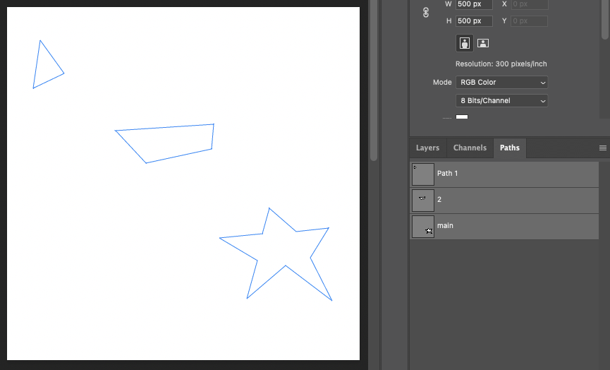

February 20, 2024
@alimedi77729338
In the following example, I expected the path named "main" to be renamed as Path 1 as it contained the most points, however the simplest path (3 points) was renamed, not the most complex?
EDIT: Once I added a sub-path to the main path it was correctly identified as being the "most complex" path.
